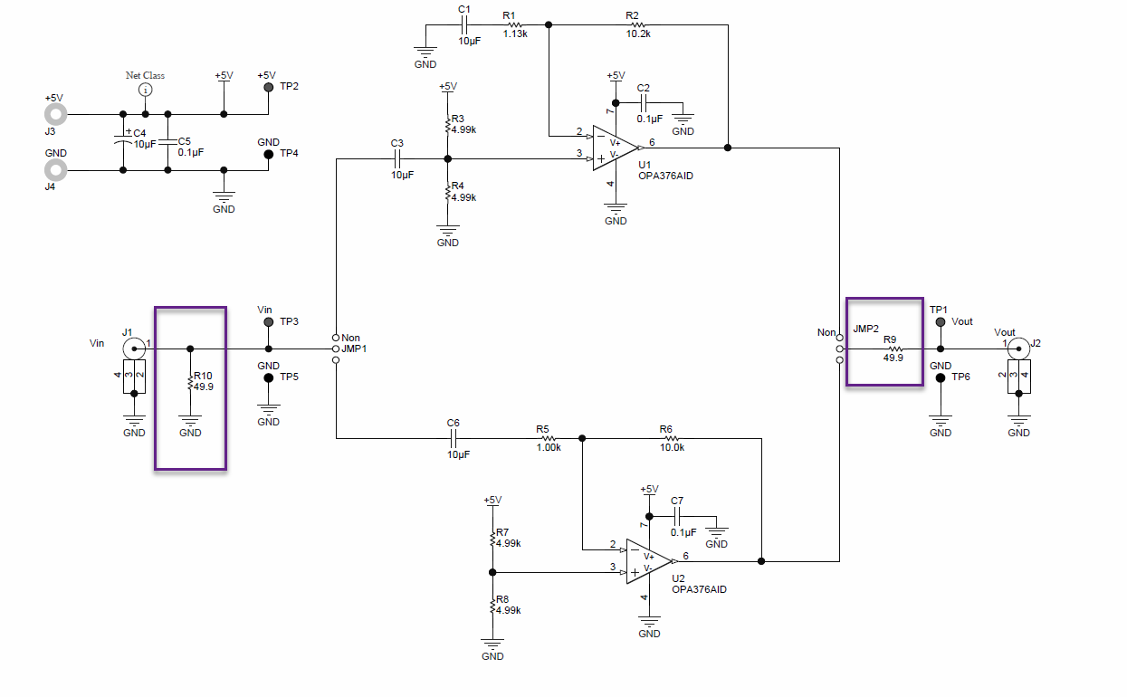

IN the reference design for AC coupled inverting/non-inverting amplifier, the board has R10 and R9 of 49.9 ohms. May I know why do we need these two resistors? Is it for impedance matching? thanks

    Yes, they are for impedance matching. The inclusion of R10, the 49.9 ohm resistor, serves as an broadband near 50 ohm termination for an instrument having a specified 50 Ohm output impedance, or a cable having a 50 Ohm surge impedance. R9, also 50 Ohms, is a back termination resistor. The closed-loop output impedance (Zol) of the OPA376 is very low. When the 49.9 Ohms is added to Zol the impedance is close to 50 Ohms, which matches the surge impedance of 50 Ohm cables.

    For R10 , isn't going to consume more current as input impedance is in parallel to capacitor? Would that affect HPF value since R10 is now in parallel with C?
    For R9, R0 is higher than 50 ohms. So why so we need to place 50 ohms in series?

    Since R10 is connected from the input connector to ground it will load the source connected to J1. That resistor will consume power when a signal is present. But if you need to avoid transmission line effects such as standing waves on a long cable, it is necessary to have R10 in place. If the frequency is low and you are not concerned about terminating a transmission line into its surge impedance, then you can likely leave R10 out of the circuit. For instance, if your input frequency is tens or hundreds of kilohertz in frequency you probably aren't going to need to terminate the line.
    R10 and one of the series input capacitors C3, or C6 form a high-pass function and with a roll-off below approximately 318 Hz. These dc blocking capacitors are needed to maintain the correct dc voltage at the op amp input.

    Ro, or Zo is the open-loop output impedance. As soon as the loop is closed the closed-loop output impedance (Zol) is presented. It is Zo divided by the very large loop gain, and results in a Zol of less than an ohm. Therefore, that very low Zol in series with 50 Ohms looks much closer to 50 Ohms when looking back into the output of the circuit.
