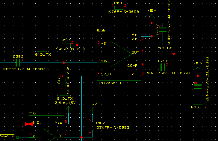

I am using the LT1206 as a pulser with +15V and -15V supply.
By pulser i mean disabling and enabling the IC with a continuous sine wave on the input.
On the output i have be sine wave "bursts" that comes in a periodic of time.
I want to use the THS4130 instead of the LT1206 and use the power down pin to "make" the burst in differential mode.
Does anyone knows how fast will it turn on and off?
I need to know because i need controll the number of sine waves in a burst sequence.

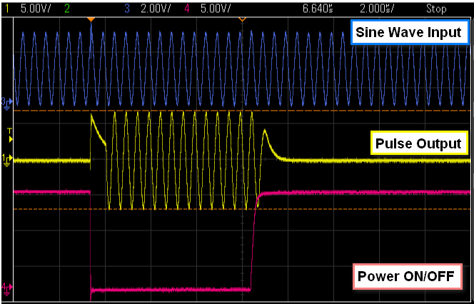

Edit:
So here is a scope from what i am doing with LT1206
You can see on the scope that it takes less than 1us to send the signal to the output and less than 1us to stop it.
Can the THS4130 do this and can this be quicker?
Here is my schematic using LT1206:
  • Hi Michael,
    as the datasheet of THS4130 doesn't contain even the least timing specifications, I would not use the power-down feature for a multiplexing application. I think it's only a true power-down in order to save supply current.
    Have you read section 8.4.1 of datasheet?
    But, as far as I know, TI has other OPAmp which can be used for multiplexing.
    Kai

  • Hello Michael,
    The THS3115 may be suitable for your application. This device can be run at at a total supply voltage of 30V, can output 270mA of current at this supply configuration and has a disable and enable time of 200ns and 300ns respectively.
    Hasan Babiker
