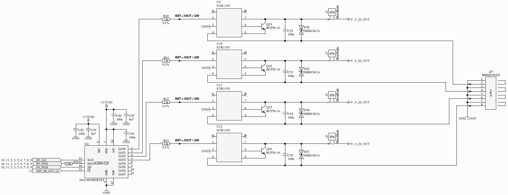

XTR115: Multiple 4-20mA loops with same loop GND
Part Number: XTR115
Hello everyone
I have the following circuit:
V_4_20_OUT is an external loop voltage referenced to GND_LOOP (not referenced to GND). When only one of the four jumpers is set everything works fine. But as soon as I set a second jumper I measure a currentflow in the first loop of up to 30mA (depending which jumper is set). And on the pin 2 of the XTR115 I measure -0.5V (output of the DAC is 0V). I do not see what the problem is and where/why the wrong current is flowing.
Thank you for your help.
