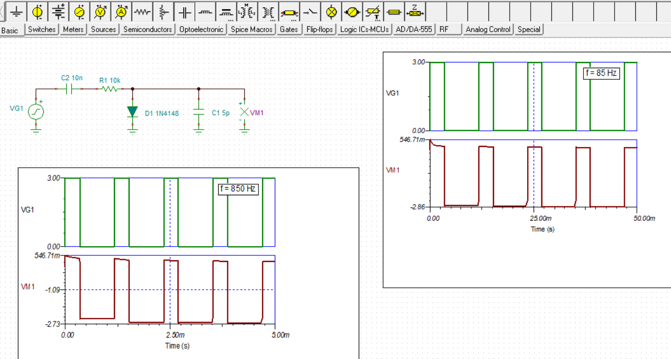

I'm looking to design a circuit using the LM2907 to measure the frequency of a motor. We are designing a safety cutoff if the motor RPMs reach 50,000, anything from 0-45,000RPMs is deemed safe.
The maximum frequency will be less than 900Hz, so we should be fine to use this component.
I'd like to run the IC off of a 3.3V supply, but I can't seem to find if that's ok in the datasheet. If not, I could run it off of 24V, but the hall signal that I'm using for the frequency input will be a square wave from 0-3.3V at roughly a 30% duty cycle, so it seemed to make sense to run the supply off that voltage too (if possible)
That leaves the selection of R1, C1, and C2. I'm not sure what these should be set to at all. I want to have 3V on the output at 50,000RPM, so I can trigger the motor to safely shut off.
If you can help me with the component selection I would appreciate it. I'd also like to get confirmation that my supply voltage will be ok.
