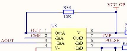

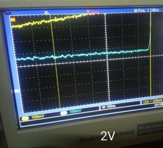

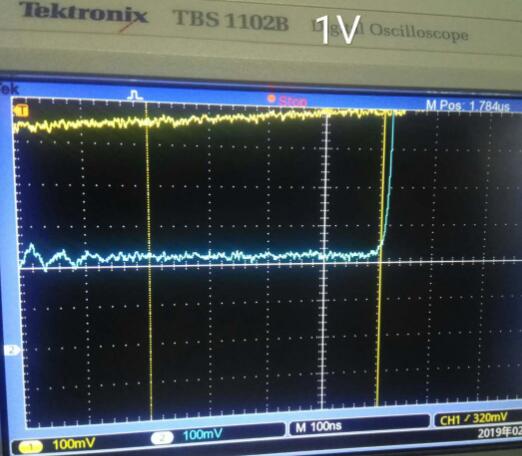

    Vcc is 3.3V through a diode, so Vcc is about 3.0V. CH1 is input sine wave and CH2 is output. The trigger level is 552mV. I measured the time duration from input(CH1) reaches 552mV to output(CH2) starts to rise from 0V. When input is 1 Vpk-pk sine wave(40kHz), this time duration is 404ns. When input is 2 Vpk-pk, it is 580ns.

  • Hi Di,
    What is the 1-2Vpp centered around? Can you zoom out so we can see the entire waveform, referenced to ground. IOW, what is the "high" and "low" voltage in respect to ground.
    At 3V, the maximum input voltage is 1.5V (1V over temperature) At the higher 2Vpp level, part of your waveform may be going out of input range and, while the output will still be correct, there will be an increase in prop delay. If any portion goes well below ground, this can also cause delays.
    Overdrive is the amount of input signal OVER the reference voltage - NOT the total p-p input voltage. So if you had a reference voltage of 1.000V, and the input signal went from 500mV to 1.05V, then the "overdrive" voltage is 50mV.
