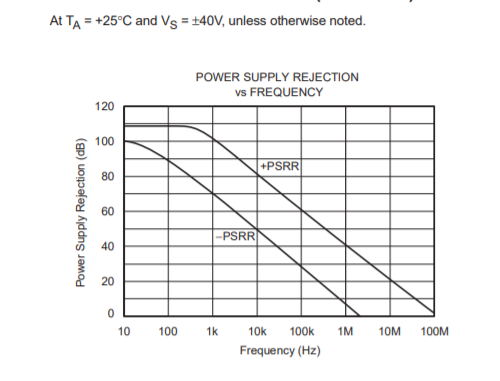

    Any ac signal, which includes noise, riding on the dc supply lines will exercise the op amp's PSRR capabilities. PSRR is highest at dc and low ac frequencies and then rolls off with increased frequency. You can see this in the OPA445 PSRR vs frequency, Typical Characteristics graph shown below. Note that the PSRR is different for each of the supplies, the positive supply having more rejection compared to the negative supply.

    AC case:  intial supply voltage Vs = ±12V. I have a noise with amplitude 0.5V at 1kHz on both the supplyies (hp: the two noises are out of  phase of 180°), so null mean but minimum Vs  =  ±11V and max Vs =  ±13V. From the plot I see that I have to consider a PRSS of  80 dB for the positive supply and 50dB for the negative supply. Let's assume that 80 dB is for both the supplies. What is the variation of the supply voltage Vs that I have to consider:
    2V (because ±11V and ±13V differ from ±12V by±1V),
    4V (because ±11V and ±13V differ by ±2V)
    58V (because ±11V differ from ±40V (the reference Vs value in the graph) by ±29V)
    54V (because ±13V differ from ±40V (the reference Vs value in the graph) by ±27V)
    It looks like you have a correct understanding about the voltage deltas used in the PSRR calculation.
    PSRR(dB) can be converted to V/V using the following equation:
    PSRR V/V = 10(-PSRR_dB) / 20 dB)
    For 80 dB PSRR
    PSRR V/V = 10(-80 dB) / 20 dB) = 100 uV/V
    Keep in mind that the datasheet graph is typical PSRR vs. frequency performance, with the ±40 V supplies.
    1) ΔVs = 2V (because ±11V and ±13V differ from ±12V by±1V),
    2) ΔVs = 4V (because ±11V and ±13V differ by ±2V)
    3) ΔVs = 58V (because ±11V differ from ±40V (the reference Vs value in the graph) by ±29V)
    4) ΔVs = 54V (because ±13V differ from ±40V (the reference Vs value in the graph) by ±27V)
    Loris
  • Hi Loris,
    Since you plan to power the OPA445 with a ±12V power supply the main interest is what the PSRR will be with reasonable supply variations range not too far outside of ±12V.  You mention a 1 kHz 0.5 V noise ridding on the ±12V dc level. The concern is how much effect it will have on the voltage offset. Therefore, I believe case 2) ΔVs = 4V (because ±11V and ±13V differ by ±2V), will provide a good measure of the PSRR in the ±12V supply operating range.
    PSRR doesn't usually vary vastly over a moderate supply range so I don't expect you would see much difference in the PSRR if you use a smaller, or larger supply voltage change. Just make sure you don't drop the supplies below the OPA445 minimum operating voltage.
