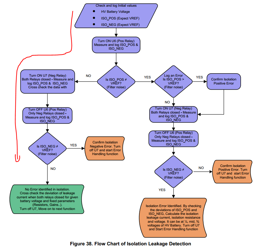

Hi
I have a question about AMC1301-Q1. I saw the Page 6 and 11 of the reference design TIDA-01513 tells the detection principle and final verification result. It confused me if the calculation formula (2) and (3) with the red underline in the picture as belows is correct or not. Because according to the circuit, this 'minus' in the formula should be 'plus'. But using VREF plus the following expression item, it won't match the test result. Can you help to check this and give me some explaination? Thanks a lot.
