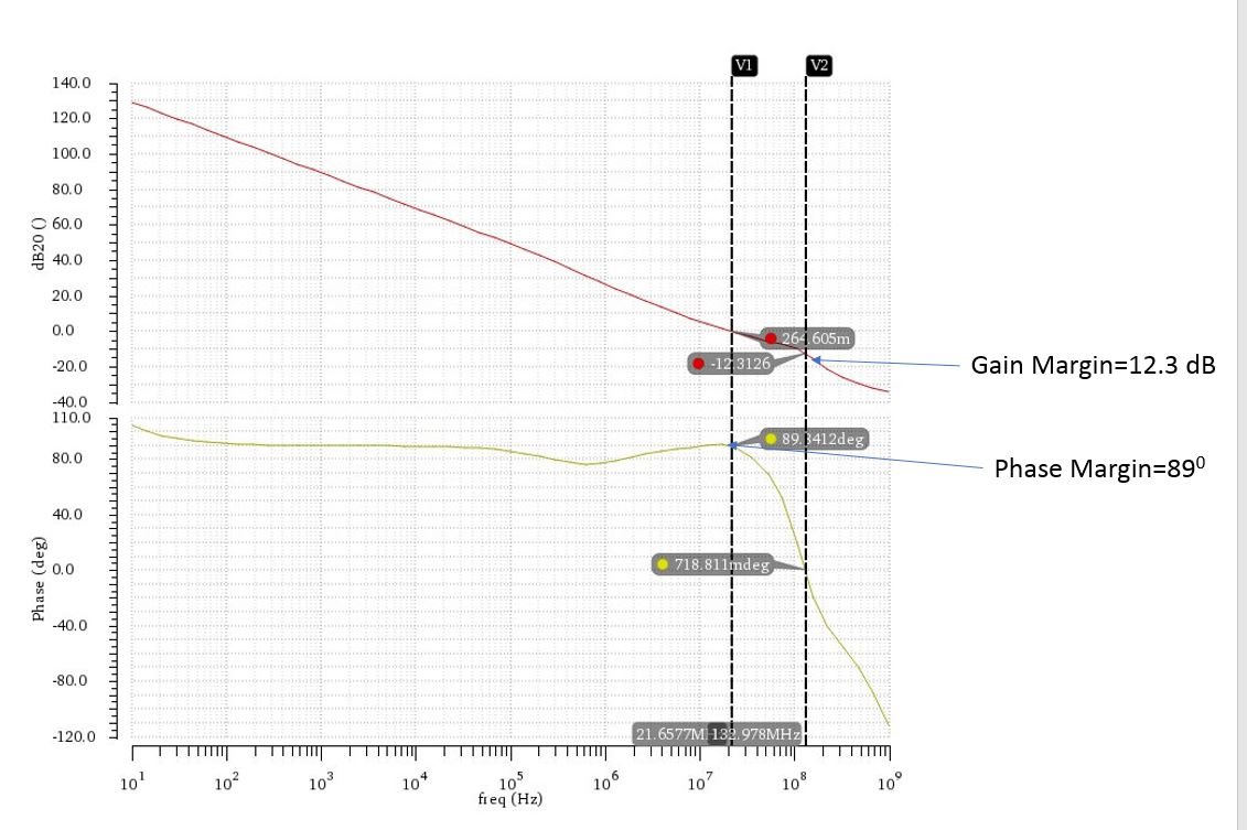

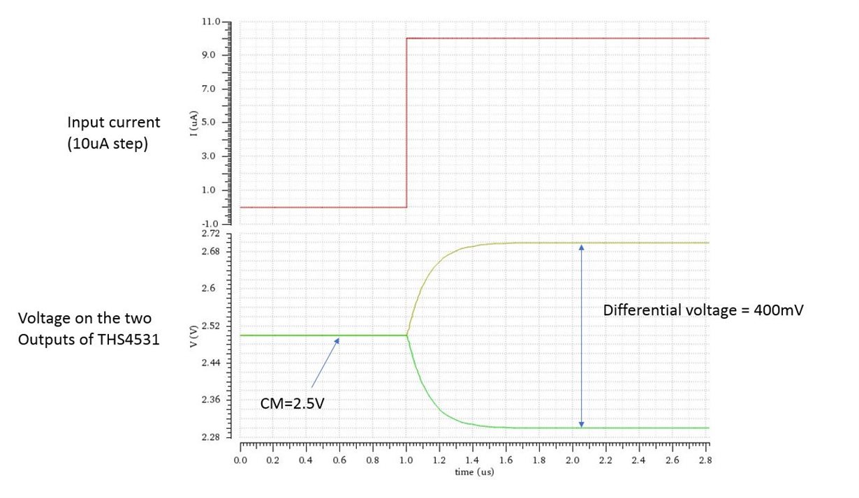

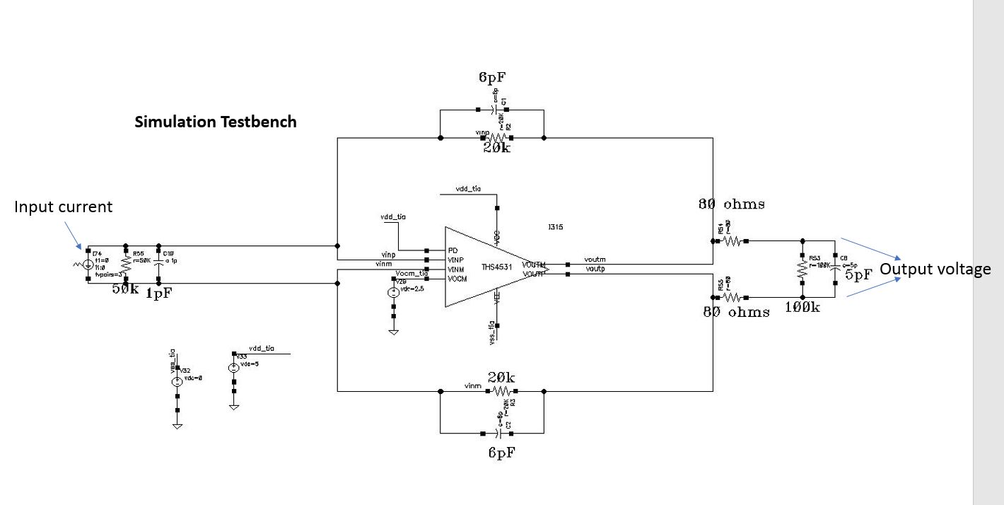

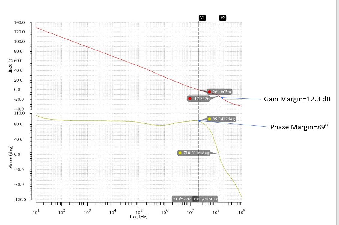

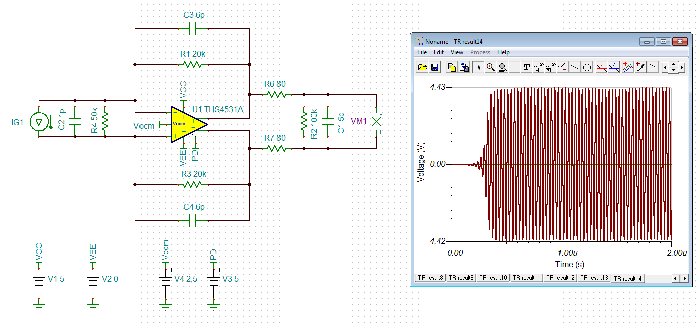

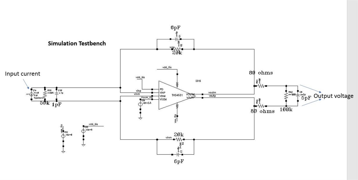

I am trying to  build a differential Transimpedence Amplifier with THS4531A.
I used a feedback resistor (which serves as Transimpedance) value of 20k in parallel with a compensation capacitor of 7.5pF
I used the pspice model for THS4531A in my Spectre simulations to check the stability.
It gives me the phase margin ~ 72 degrees and Gain Margin ~ 16dB. which looks good enough to me.
My question is : Can I trust these spice models for the stability simulations I did in Spectre ?

  • Hi Ashish,
    can you attach your TSC-file?
    Kai

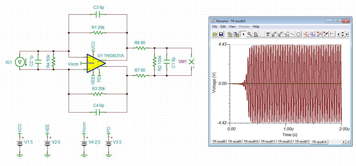

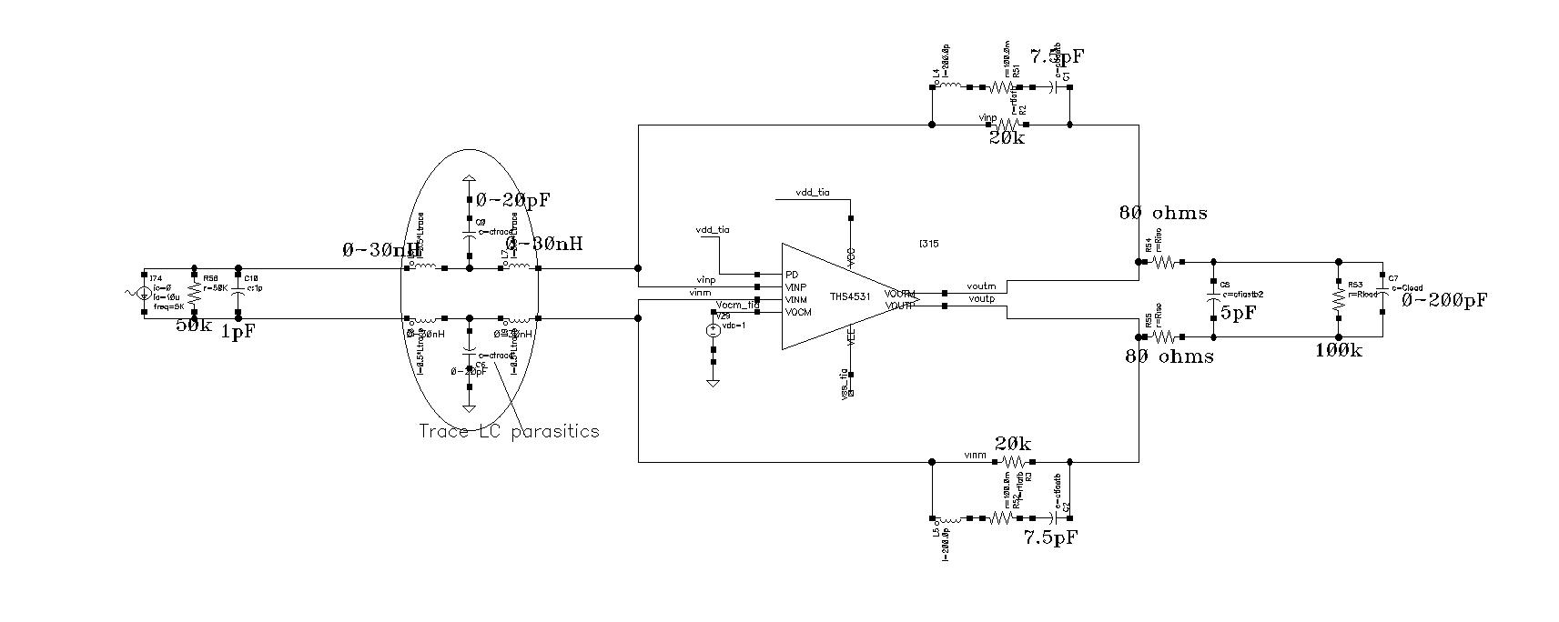

     ran into more stability issues with the transimpedance amplifier I so designed.
    I am running Spectre simulation with the pspice model of THS4531A. Hence I don't have the TSC file. I am attaching the spectre simulation file (input_scs.txt), the p-spice model for THS4531A (ths4531_lib.txt) and the snapshot of the Transimpedence amplifier schematic I am using for my stability simualtions (TIA.jpg).
    Please let me know if this helps.

  • Hi Ashish,
    the circuit does not seem to work stably:
    ashish.TSC
    Kai

  • Hello Kai,
    I tried to run transient simulation with the setup you posted in Spectre (using the p-spice netlist of THS4531). I don't see any oscillatory behaviour.
    I guess you ran your simulations on TINA netlist of THS4531A.
    Can there be a difference between the pspice netlist and TINA netlist of THS4531A ?
    regards,
    Ashish

  • Hi Ashish,
    what OPAmp are you using, the THS4531 or the THS4531A?
    Kai
  • Hello Kai,
    you are right. I was talking about THS4531A but took the Pspice netlist for THS4531 instead.
    This goof-up happened because the "Tools & Software" section for THS4531A (www.ti.com/.../toolssoftware) lists THS4531 Pspice model in 1st row. So I simply took it without noticing that there is THS4531A Pspice model also available in the 3rd row.
    After taking the correct model for THS4531A, now I get results similar to what you mentioned earlier. Even the stability parameters in AC simulation (in Spectre simulator) also shows negative phase margin.
    Thank you very much in helping me out with this.

  • Hi Ashish,
    when you put the THS4531 and the THS4531A into the TINA-TI reference design of THS4531A, the frequency responses and the step responses look totally different, as if the THS4531 and THS4531A are totally different OPAmps, allthough the datasheet specifications are identical. So, there must a mistake in the spice models or in the datasheets.
    Kai
  • Thanks for informing me.
    I will raise another issue here asking to confirm if these difference is indeed correct.
    regards,
    Ashish
