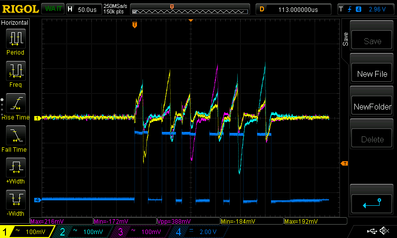

I have trouble to get a coherant measure of current in each phase... I fact i am developping the controller board using a pre-existing powerboard to speed-up the task. But  this power board has only shunt resistors on each phase but no common shunt... and it is realy low resistors  (i mean pcb trace) about 50 micro-ohms...
I'm trying to get the rotor position using the inductance variation method, shortly I drive High to phase and the third is driven low and then reverse the phases...
Here you can find some pictures of waveform :
First pulse U and V are pushed to 30V and W is driven to 0V then in the secon pulse W is driver high end U and V are diven low...
The current is taken from the shunt resistor to an INA225 with G=100 and a ref voltage around 0.5V.
Currents : Yellow = phase U, blue = phase V and pink = phase W...
Is someone can explain me why in the first pulse I catch a current in every shunt ? I mean why the yelow one is following the other ones ??
Mosfet is off and I've done many simulations and I can't understand why the op amp amplify this ghost current...

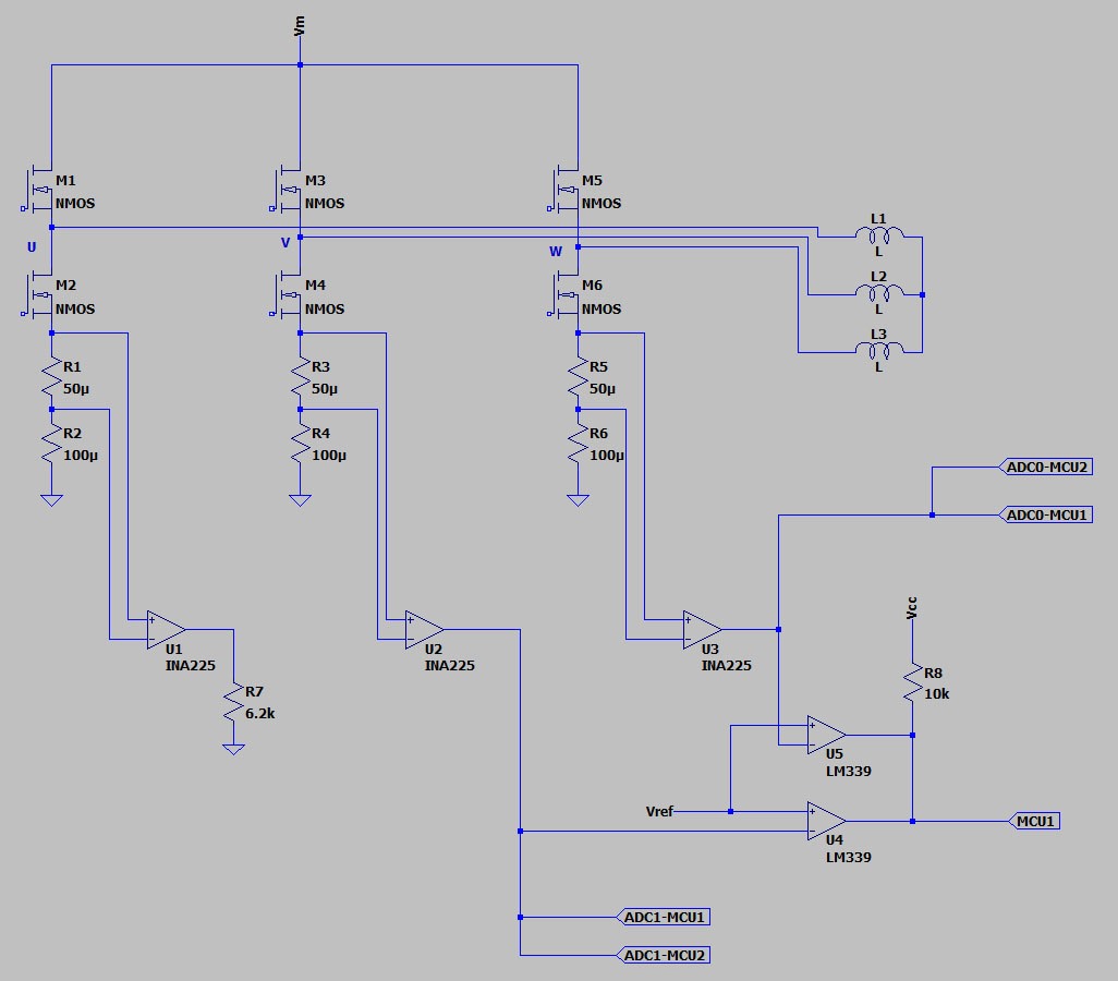

Here is a schematic of one simulation with layout resistance of the bridge
I can' t explain what I see on the scope...
I'm pretty sure this current does not exist !

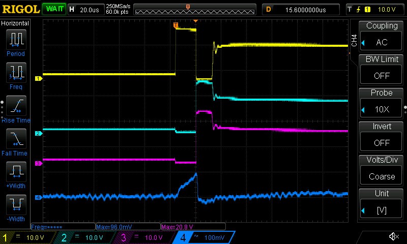

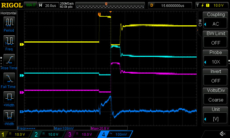

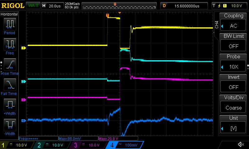

  • Hello Patrick,
    Ch1 = U phase
    Ch2 = V phase
    Ch3 = W phase
    Ch4 = Vsense on U (picture 1), V (picture 2) and W (picture 3)

  • Hello Raphael,
    That defies what we would expect. However, I do have a possible theory. The outputs might be coupling onto each other. From your graph it appears as though 2 INA225 outputs have the same initial droop and overshoot with the rise, while the other appears to have a more smooth RC charge rise characteristic. Possibly one of the signals is filtering through onto the output you expect to be low. So to test this theory, I first would like to cut the connection between the source and shunt on the low-side that is expected to be off. This should guarantee that nothing is passing through that shunt. If the output is still unexpectedly high, reconnect that source and shunt and then cut the output trace. Probe at the output pin and see if it still rises when it is expected to be low.

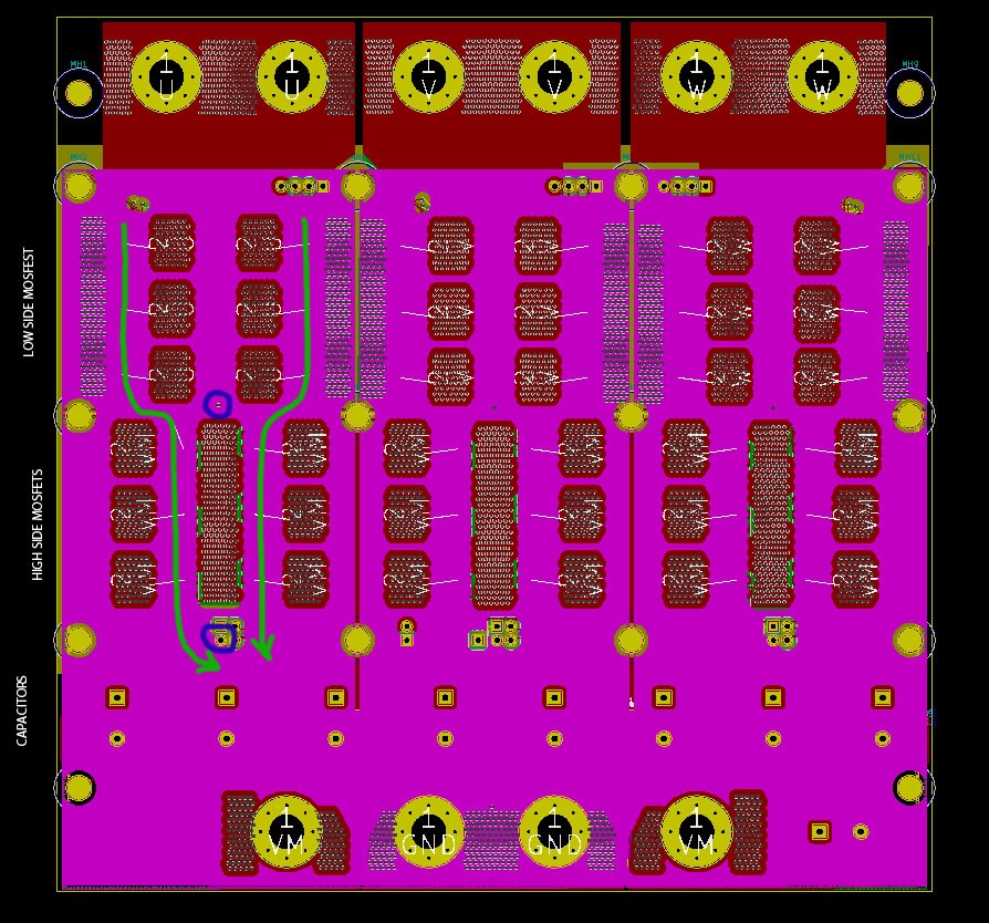

    In fact the schematic i've posted is what I suppose to be. The power-board is not our own, I use it to speed-up development. The power-board carry only mosfets and capacitors. I don't realy know how are the inners layers. I have done a virtual pcb, folowing the real one for external layers and  guessing how are the inner layers.
    All resistance was measured at DC with 7 amps and HP 3468A multimeter.
    Here is a picture shownig how I think the inner layer is.
    Green arrows are the current form low side source to main capacitor.
    In the blue circle you can see the start and the end of shunt resistor.
    You talk about coupling, and I agree with you, especialy when I look at the negative current in the first oscillo sceenshot that reflect a bit on the next sceenshot and disapear on the last, reducing when the distance grow. But this effect is very strong, all the peaks are very close.
    Thank you for your help.
    Best regards.
    Raphael Reynard.
  • Hello Raphael,
    I dont see an obvious issue with that board. However, I will discuss this with my colleagues and see if they may have any thoughts on what could be wrong.
    As for your INA225 outputs, do each of these feed directly to a different adc pin on a microcontroller or do you feed them through some sort of mux. If there is a mux, perhaps there is crosstalk that is allowing the signal to couple. As it is difficult to cut your output trace, could you alternatively lift pin 4 of the INA225 off the board and attach a wire to probe this output pin? If you can confirm that the output does not change after this, then we can confirm the behavior is not a result of some downstream circuitry.

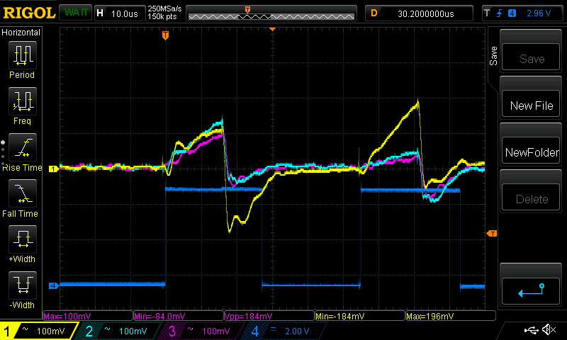

    No extra  mux but adc input of two mcu and it is muxed inside mcu. And ouput of INA225 feed a comparator (LM339) to...
    I've disconnected output on U phase and loaded it with 6.2K to ground and here is a scope screenshot :
    Ch1 is U with op amp disconnected from mcu/comparator
    Ch2 and Ch3 are V and W (with op amp connected to mcu/comparator).
    First pulse : UL VH WH
    second pulse : UH VL WL
    Thank you.

    So if I understand correctly, your bridge circuit for U looks like the figure below?  If so, this is not expected behavior from our device.  To determine if this is an issue with our device or with the system,  I have two additional tests you can perform.  One would be to take a high-side measurement.  If in fact the current is real, I think we should see the high-side current sum up to the current passing through all three of the low-side current shunt monitors.  In this test I would also recommend removing the 6.2kohm resistor.  The other test you can perform would be changing the shunt resistor on the U leg.  If you change the shunt to 250uohm, we should see the output amplitude from the INA225 get 5x larger.  This would also indicate if excess unexpected current is passing through the shunt.

  • Hey Raphael,
    Thanks for the clarification. Based off that, we do think that there is current actually crossing through R1 when it should not. To determine where it is coming from one test would be to disconnect node U from L1, this will tell us if for current is feeding through from the inductor. The other test you could also try would be to desolder R1 and probe for a short to the high-side of R1. For this I would first check if the high-side of R1 is shorted to the high-side of R3 and R5, then to V and W, then the output of U2 and U3. I would check these resistance as well if possible.
