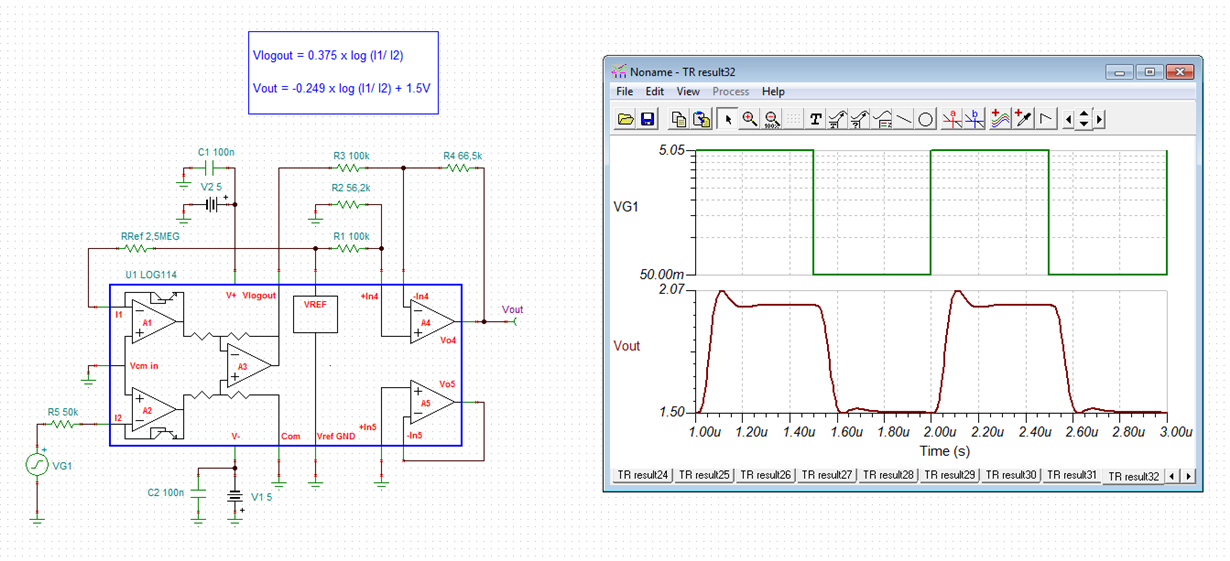

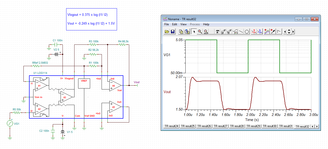

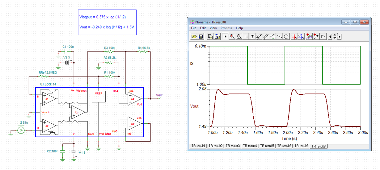

  • Hi Andrey,
    the simulations show that it should work:
    andrey.TSC
    andrey1.TSC
    Could it have to do with your setup? Is there any cabling involved or stray capacitance? Is the circuit breadboard mounted? Remember that the LOG114 is high-speed logarithmic amplifier. You should use HF mounting and measuring techniques. Also, a 1:1 scope probe can show a huge capacitive load to the outputs of LOG114. I would use a 10:1 scope probe. And don't directly touch the outputs of LOG114 with the scope probe. Insert a 47...100R isolation resistor which you mount directly at the output pin of LOG114.
