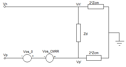

I'm using a model of my op amp that accounts for the basic offset voltage Vos_0, the offset voltage due to the CMRR Vos_CMRR and the input impedances (Zd: differential impedance; Zcm: common-mode impedance). I have a doubt about the evaluation of the common mode voltage Vcm. Shuld I evaluate Vcm as (Vp+Vn)/2 or as (Vp'+Vn')/2?

  • Hi Kai,
    I need this kind of information because I have to develop a general model for my application, so it has to be function of the standard parameters used in the characterization of the op amp.
    So shuld I evaluate Vcm as (Vp+Vn)/2 or as (Vp'+Vn')/2?

  • Hi Loris,
    An ideal voltage source has zero impedance, and that should be the case for the Vos_0 and Vos_CMRR sources. They simply add or subtract a voltage to Vp', relative to Vn. In  actual op amp testing the CMRR is measured with these offsets in place, and the device must deliver a specified level of CMRR performance. Therefore, it appears the Vn and Vp are the points you would use to evaluate the CMRR.
