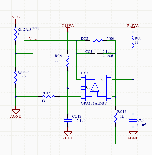

I am using this device to measure the current of a power supply
The device is configured as an inverting amplifier
Power supply +/-15V
Rfeedback = 100k, Rgain = 1k
also a 1k resistor from non-inverting input to ground for offset compensation
I am measuring current on the low side (sense resistor connected to ground)
Gain is 100
Rsense = 0.003 ohms
Current level about 1 amp
Vout = -100 *0.003*1 = 0.3Volts
Any suggestions will be appreciated
Thank you
