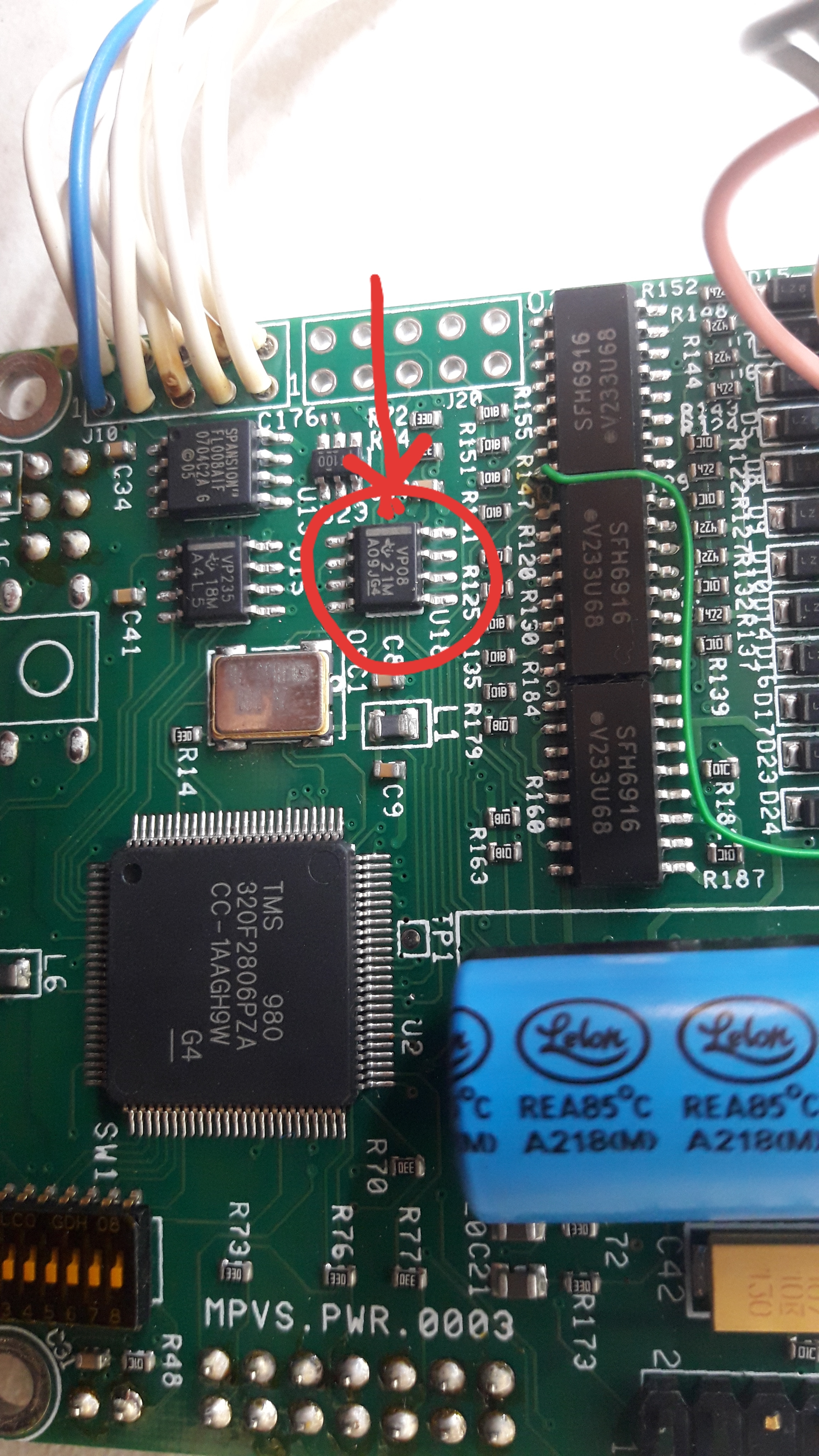

I am Hossein and I need data sheet of the "vp08 21m a09jG4". This word ("vp08 21m a09jG4) writed on element .I don't know that what is this element(ic or...) I hope you can guide me.

Hello Hossein, this device is the SN65HVD08D 3.3/5-V RS-485 Transceiver.
I have forwarded this post to the Interface product group.
The data sheet you attached has no proprietary information, so I am attaching it to this thread for the product owners to view.
/cfs-file/__key/communityserver-discussions-components-files/14/SN75HVD08D-data-sheet-mark-up.pdf

As Kai pointed out on the digikey forum, the G4 was originally used to designate Green/Lead Free parts. All of our parts are now Green, but in some cases we have leftover stock...once these are sold the G4 suffix will go away. Functionally the parts are identical.
