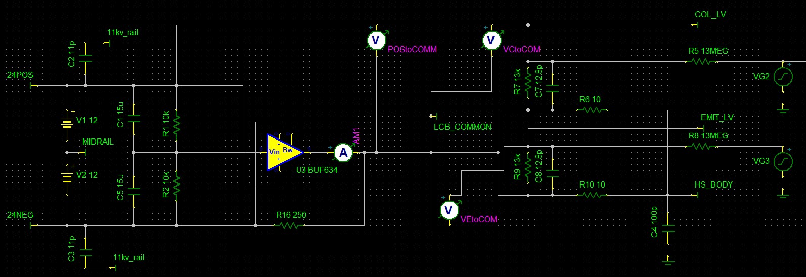

I am simulating the INA188 using the TINA-TI model that I have downloaded from its web page (this part is not available in TINA-TI included parts).
It simulates fine standalone, but when I include it in a more complex circuit, it seems that the INA188 inputs cause a disitrortion of the input signals.
In this circuit, the INA188 inputs are fed from a high voltage (high impedance - 13Mohm) differential divider.
When I change the INA188 to a simpler TINA model (e.g. INA826 which is included within TINA-TI) - I dont see this issue.
I can see that the INA188 is far more complex, but I wouldn't expect this input distortion behavior, since its input impedance is 100Gohm.
Please advise.

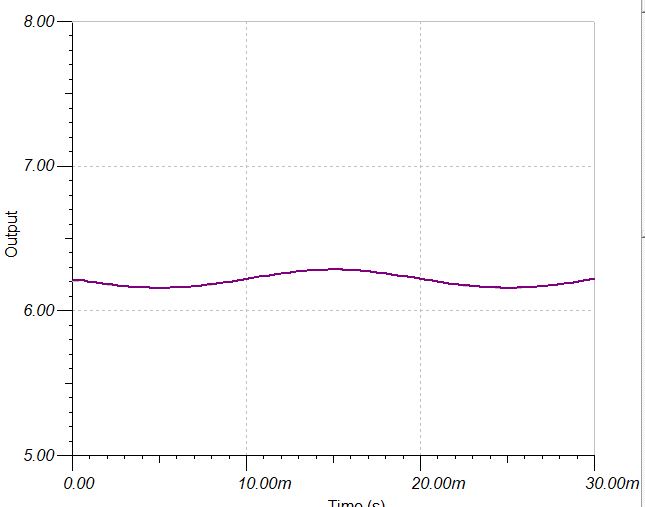

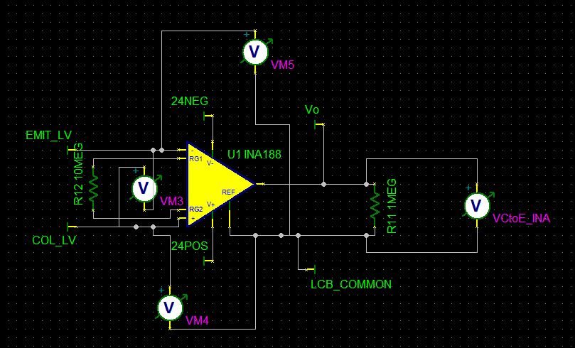

  • Hi Alex,
    See attached circuit sections (I can email you the full file if needed) and two output plots.
    Both outputs show the differential voltage at the input of the amplifier. One is with INA188 and the other is with INA826.
    In the INA188 the output signal is also wrong and is essentially jumping from positive rail to negative rail.
    The REF signal is generated by a rail splitter as can be seen in the circuit (this is a floating circuit).
    Circuit:
    Distorted Differential input to INA188 (VM3):
    The same non distorted input in a simulation that replaces INA188 with INA826:
    Uri

  • HI Alex,
    Following your advice - I re-arranged the ground in my TINA circuit such that both the INA188 and the BUF634 are tightly coupled to the SPICE ground.
    The "real-life" ground was simply renamed (so in effect nothing electrically changed).
    This enabled the simulation to converge and run quickly and without issues.
    Many thanks for your support.
