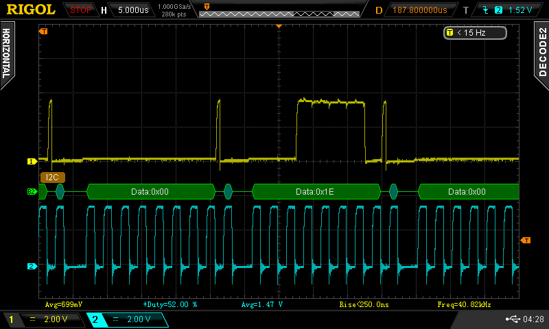

    I also took some scope images of the returned sample count low-byte equaling 0 and 30. I also have an image of the the lowbyte equaling 60 that I can post if you like.

  • Hi Guang,
    I have continued to experiment with different settings.
    And it appears that reducing the speed to 100kHz has avoided the problem!
    However, the problem persists at 200kHz and 400kHz, despite great signal integrity and all other communication working fine.
    I get the impression that the INA233 is having trouble handling 400kHz packets and it is disturbing the sample counting mechanism.
    The INA233EVM dongle unfortunately operates at ~16kHz so I don't think I can use it to reproduce the error.
    So far it appears the following conditions cause the sample counting problems:
    1. 400kHz I2C speed
    2. Calling a voltage read during power accumulation (other commands may also cause it)
    Here is other info about my exact setup, although I don't think it has an effect on the issue:
    VCC: 3.318V,   I2C Addr: 0x40(GND,GND),   Shunt: 0.0025ohm.   Shunt conversion time: mode 4,    ADCVoltageConversionTime: mode 4 ,   ADCAveraging: mode 2.   CAL = 2048
