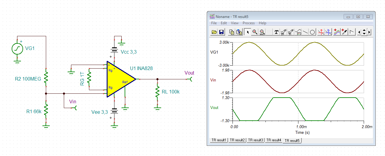

I have run into a strange issue with the INA828 instrumentation amplifier. Below is a description of the problem.

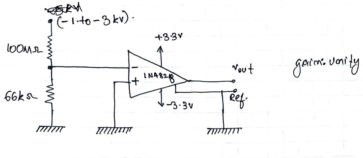

I am using the INA828 instrumentation amplifier to measure a negative voltage, which will eventually make its way to an ADC input. To make the input positive and make my measurements proper and also to get rid of the common mode signals, I have used the instrumentation amplifier. I have connected the IC in the following configuration shown below:
The positive input was grounded as I had to flip the polarity of the signal to be able to feed it to an ADC. The sensing signal is also grounded as shown in the figure and I am using the amplifier at unity gain (Indicated by the gain resistor across pins 1,8 at infinity or NC). The output to input transfer is shown the figure below. Please note the negative voltage on the x-axis
One expects the output to saturate at 3.3 volts. But it was observed that the amplifier saturates prematurely at 2 volts. Is there an explanation for this? How can I possibly fix this issue?
