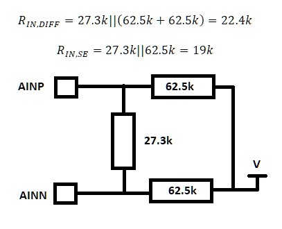

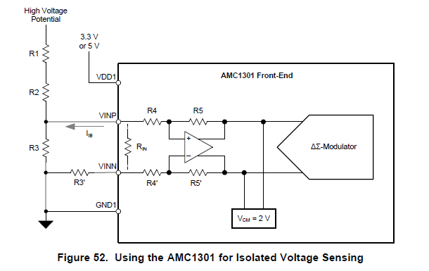

My customer wants to know how to calculate the input impedance of AMC1301-Q1? In datasheet it showed two spec:
Given internal R4 & R4' = 12.5kohm and R5 & R5' = 50k. How is 18kohm and 22kohm derived? Can you provide an equivalent circuit to show how RIN is derived?
