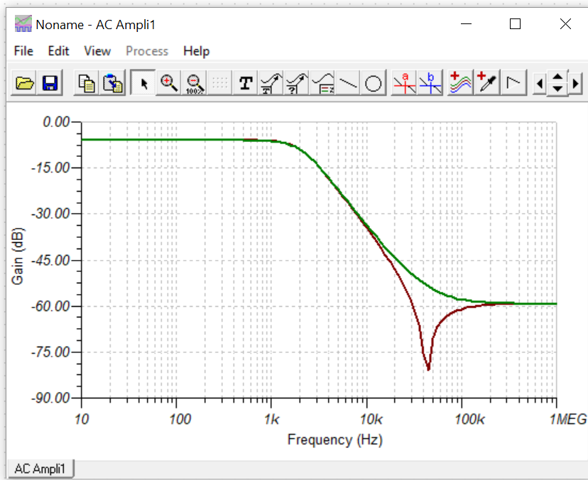

All the examples that I have seen when converting a single ended signal to differential have at most 1 low pass filter stage. Is it okay if I add a 2nd low pass filter stage? The circuit would be a 2nd order low pass filter, converting a single ended signal to differential. I modeled the circuit in TINA and the non-inverting output seems to be resonant at approximately 50KHz, but the inverting output seems fine.

  • I believe that I did not have the FDA connected correctly in TINA - things make more sense now.
    I attached a screenshot of the output and am curious why the maximum attenuation is -60dB for the non-inverting output?

    Your design is essentially a 2kHz gain of 1 Butterworth followed by a 722kHz RC pole once the feedback cap shorts out. The design is pretty high noise, I ran an integrated noise to 10kHz, 23uVrms.
    What is your minimum input resistor target, I can generate a lower noise solution pretty quickly with that if you would like.
  • Actually, just tried this - it appears that to keep the caps lower the R's are in fact pretty large, can't improve noise much.
    The R's dominate the output noise - not really using the great input noise of the OPA1632. If your application can use a single 5V solution, the THS4531A might be enough at much lower power.

    I limit my MFB tool to max 33nF as the the current limit for low cost C0G caps. If you do that in a 2kHz design, your R's are going to be large.
