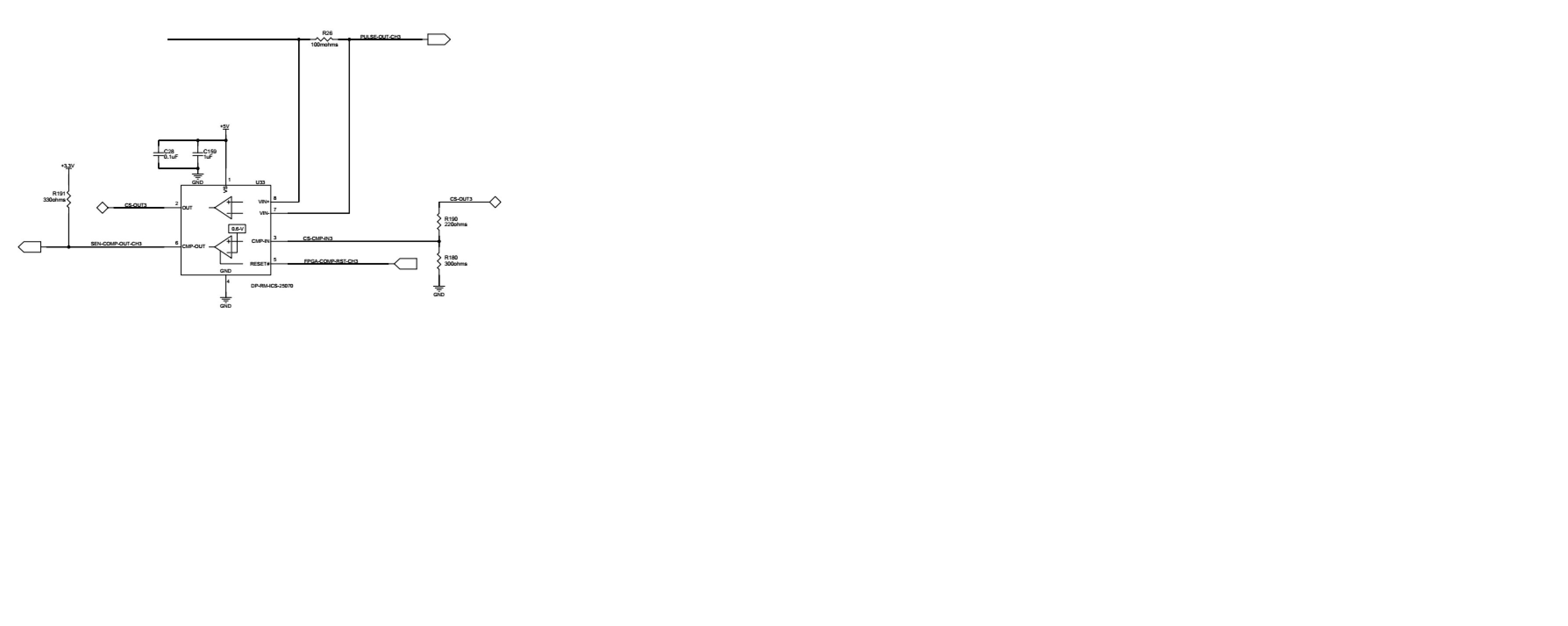

INA200AIDGKT IC is being used in a over-current sensing & protection application(Schematics attached). Output voltage is not a continuous one  but a pulsed one.Details of pulse is mentioned below:
ON Time : 1.5mS; OFF Time : 98.5mS; Voltage Amplitude: 2.5V to 40V; Load current : 100mA(constant load); Over-current limit : 500mA.
So the duty of INA200 IC is clearly to disable the gate driver whenever load current crosses 500mA; I mean only when the load current through sense resistor goes beyond 500mA, Comparator must go high.But interestingly during testing i found that the out pin of amplifier goes high at all the rising edges of the output  pulse even though output is at no load condition. And sometimes this causes the comparator output to go high (false trigger). Scopeshotsattached for your reference.

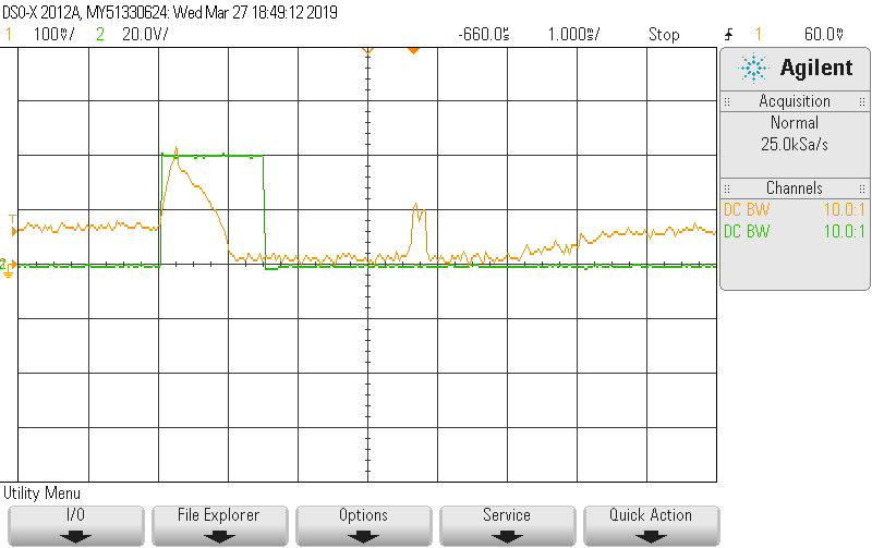

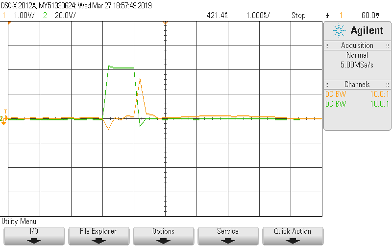

    Scopeshot 1 is captured for pulse of ON Time 1.5mS, OFF time 98.5mS, Voltage 40V & output at no-Load; Scopeshot 2 is captured for pulse of ON Time 1uS , OFF Time 99uS, Voltage 40V & output at No-Load.
    Green is output pulse while yellow is amplifier out.
  • Green is output pulse & Yellow is amplifier out

    This seems to me like a problem with AC CMRR. When you say the output is pulsing I assume you mean node “Pulse-Out-CH3” and this is essentially the common-mode voltage (VCM) of INA200. When the VCM changes this induces an input offset voltage into the internal current sense amplifier. Now as this offset changes more rapidly the CMRR begins to degrade. This is shown in Figure 5 of data sheet.
    For this system VCM step is large (40V) and is happening quickly. In your second plot the VCM step could be considered having a frequency of 1MHz and figure 5 implies that CMRR can drop to 50 dB at 1MHz extrapolating with -20dB/decade slope. You can calculate the offset change as 40V* 10^(-50/20) = 126mV. If this is gained up by 20 that turns into 2.53V on the output. Even at 70 dB CMRR (100kHz), the VOUT change is 253mV.
    On top of all of this, the sense voltage at 100mA is 10mV and this is underneath the specified 20mV we characterize the part with. As the data sheet explains, when Vsense < 20mV, the device is not operating linearly anymore and the output can become saturated at 0.4V (when VCM=0V and VS=5V) according to Electrical Characteristics table. This is something to keep in mind.
    The problem could be mitigated by filtering the output with filter before the comparator.

    The total ON time of the pulse should have less to do with the CMR when compared to the effects due to the actual rise/fall times of the pulse. What is actually generating the output offset is the quick voltage step of VCM, not the ON time. If the VCM was to ramp much more slowly with a rise time of a few milliseconds, then the internal amplifier would have time to correct any changes in the input offset (Vos) and thus no glitches on the output; however, in your initial plots, the rise times are ~25us and ~200ns respectively. This quick rise in VCM can be considered the partial zoom-in of a continuous sine-wave with a frequency much faster than frequency of the actual pulse.
    I could see that when you decrease the ON time enough, there could be a compounding effect in the output offset since you have two large VCM steps occurring very close to each other. Before the output has time to settle from 0V to 40V step, the input is driven from 40V to 0V quickly. When you increase the ON time you put time in between these rise and fall times and thus give time for the output to settle before being bombarded with the step down VCM.

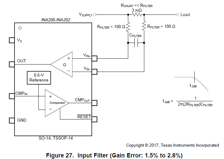

    Another option is to place a filter at the inputs of INA200 for example capacitors from IN+ and IN- to ground that would dampen the VCM step and thus slow down the rise time, although this of course will add capacitance to your load and this might not be possible in your system. Adding some current-limiting resistance on the input traces would help reduce the instantaneous current needed to charge the capacitors for every 40V step, but these resistors add error and this is discussed in section 7.4.1 of datasheet.

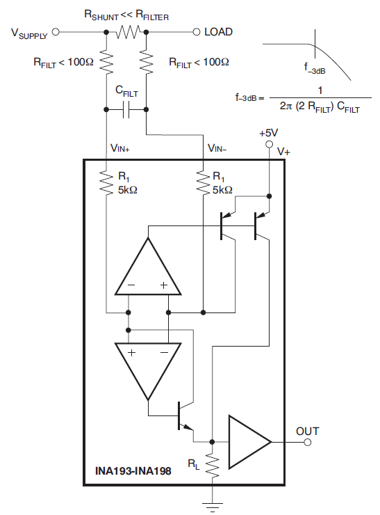

    Using two resistor-dividers at each input pin of the device (VIN+, VIN-) is not a good idea. Not only will this load down your source power, but you will also generate significant error at with your Vsense. Even if the resistors are perfectly matched, the mismatch in IB+ and IB- currents will generate a net differential voltage offset and this will severely impact the true shunt voltage you are trying to sense. If you make the resistors larger in value you will reduce the power loss from your bus voltage, but you will dramatically increase input offset error. We usually recommend for many of these devices that you limit the input resistors to 10Ω. For this device the datasheet recommends limiting the resistors to 100Ω as discussed in section 7.4.1. Note that for this device there are 5kΩ (±30%) resistors from the input pins to in actual inputs of internal amplifier.
