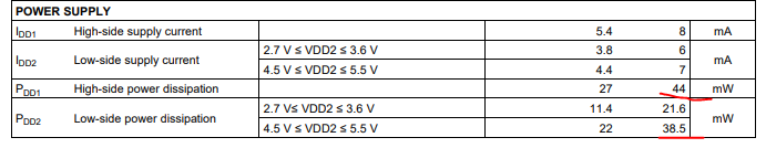

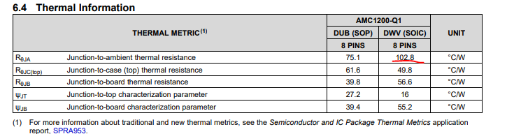

in AMC1200 datasheet, the absolute max ratings, max Junction temperature Tj is 150 degree C.
but in recommended operating conditions, max operating ambient temperature is only 105 degree C, why this data is not 125 degree C?
this device is a low power device, check the datasheet as below, the max power loss is 44+38.5=82.5mW
Ploss*RJA=82.5mW*102.8 degreeC/W=8.48 degree
TJ=105+8.48=113.48 degreeC,  which is much lower than 150 degreeC
if choose max operating ambient temperature 125 degree C.
TJ=125+8.48=133.48 degreeC,  which is also lower than 150 degreeC, it still can meet max Junction temperature limitation.
now, customer want to know, what's limit max operating ambient temperature of AMC1200-Q1? can AMC1200-Q1 working in 125 degreeC ambient temperature?
thanks.
  • Hi Max,
    As stated in the AMC1200-Q1 datasheet:
    AEC-Q100 Qualified With the Following Results:
    – Temperature Grade 2: –40°C to 105°C
