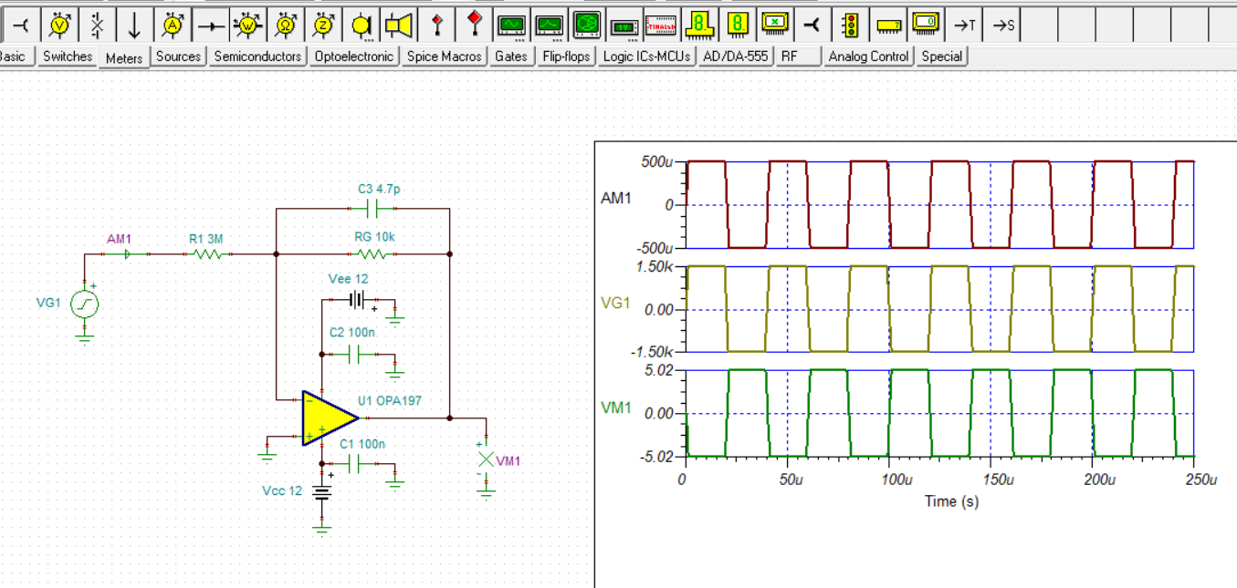

  • Hello user5994204,
    You indicate that the 25 kHz input square wave is converted to a +/-500 uA maximum current via the 3 Megohm input resistor to the TIA. Based on your inputs I have put together a preliminary TIA where for a +/-500 uA square wave input signal produces a +/-5 V output voltage. A 10 kilohm gain set resistor is used to establish a transimpedance gain of 10 kV/A. The TIA output voltage is on the order of +/-3 mV, with the +/-0.3 uA minimum input current.
    Do realize that the input voltage driving the 3 Megohm resistor would have to be +/-1.5 kV for that level of output current. If that is the case make sure the 3 Megohm resistor is designed to handle that high voltage and does not breakdown, or have an external leakage path around it. If that high voltage were to reach the TIA op amp input that would pretty much assure its destruction.
    I selected the OPA197 for the TIA op amp. It has low input bias current, low noise, wide bandwidth and everything your TIA needs for high performance. You can find the OPA197 datasheet here:
    http://www.ti.com/lit/ds/symlink/opa197.pdf
    I put together a preliminary TINA circuit and modeled the transient response. More development may be needed, but consider this a starting place. Most any op amp driving the input of an ADC will require an RC network between the op amp output and the ADC input.
    Here's the TINA file:
    OPA197_I_to_V_01.TSC
    Note that your application first does a voltage-to-current conversion, followed by a current-to-voltage conversion. If you want you may be able to simply set up a voltage divider with the 3 Megohm resistor and a 10.033 kilohm resistor to ground. Then buffer the divider output with an op amp buffer stage. That would result in a non-inverting amplifier solution having wider bandwidth. You may want to try simulating that idea and see if it does what you need.
    Regards, Thomas
