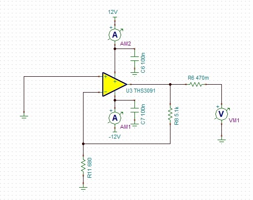

We have finished assemblied and tested the simple non-invert input amplifier using ths3901.
The schematics is as follows:
In real circuit, we replace the AM1 and AM2 current meter with 100mR current shunt resistors and measures the crossed voltages by a Keysight 6 1/2 DMM.
The measurement results show both AM1 and AM2 are about 9mA (actual voltage cross the 100mR resistor is 0.9mV).
However, the simulated results in TINA are different, which are as follows:
You can see the simulated current is almost double than real circuit values. So can you help us to identify the reasons?
