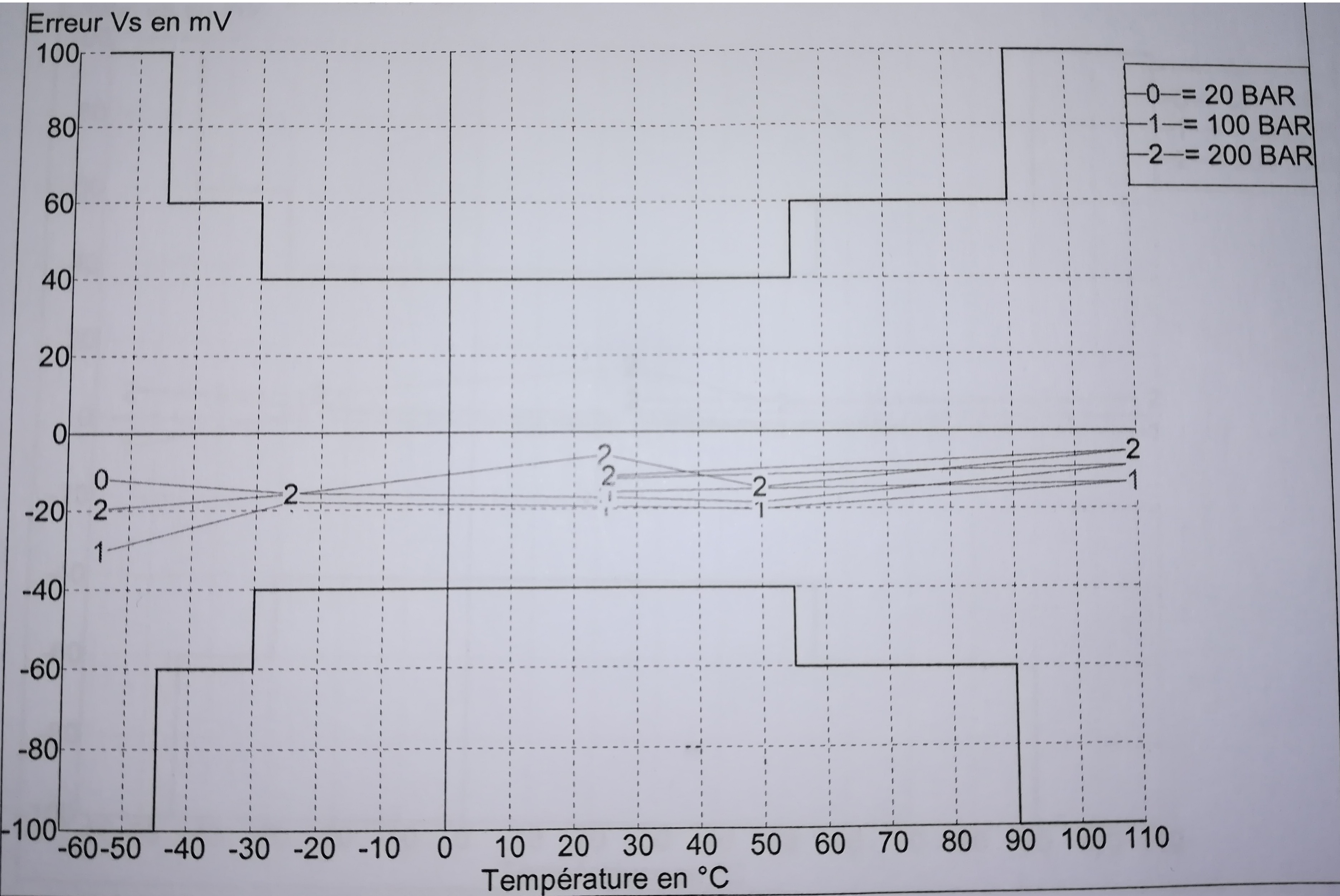

I use your PGA309 in a prototype I made. The component seems to operate correctly. I compensate our pressure sensor in pressure and temperature, but  sometimes there is an output offset after a 125°C temperature step (-20mV). Our pressure sensors are used to provide a 0 to 50mV FS and I tune the PGA to reach a 1V to 5V output. I tune the output with ±2mV accuracy from -40 to 125°C in Test Mode, and then I flash the EEPROM. After that I calibrate all the sensor in stand-alone (pressure and temperature) and the result seems correct but with a -20mV offset. This does not come from our pressure cell ...
have you ever seen this problem ?*

    When I tune the sensor in test mode, the error is less than 1mV for each temperature or pressure step. But when  I measure the sensor a few days after the result is 10mV lower ...
