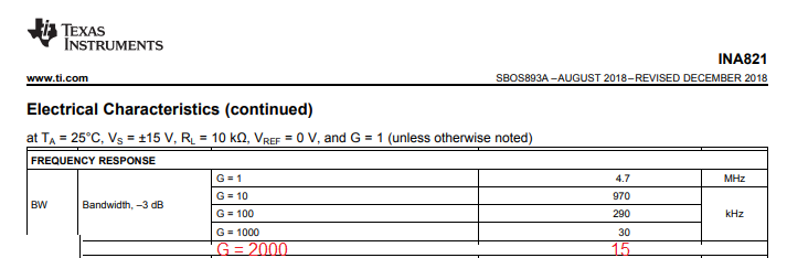

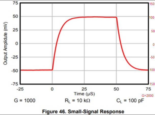

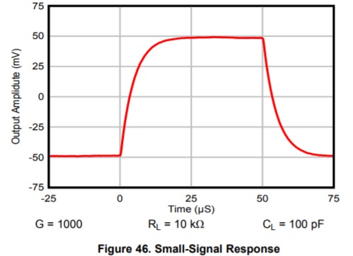

Hello team,
The customer is interested in INA821 because A single external resistor sets any gain from 1 to 10,000. He is considering G=2000 case, and he would like to know the performance of Small-Signal Response and  Gain vs Frequency in case of of G=2000. The customer would be check with TINA-TI, but he would like to know the measurement data if possible before his evaluation. Would you please provide the performance data of G=2000?
Your help would be  appreciated.
