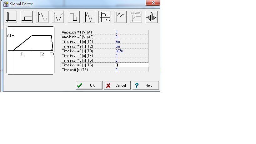

    I use TINA and webench's simulation tool to find the right component. 25KHz noise can be solved with LPF and is easy to design. But I have not yet found a suitable 450Hz solution to meet the requirements of MEMS control system. I tried LBP, BPF and notch to reduce the 450Hz harmonic, the best simulation result is UFA42 notch filter, the results are as follows. But we can find some distortion in the waveform(vout/VF1).

  • Hi Tseng,
    this comes form the abrupt changes and sharp edges of your input signal. A bit input low pass filtering can help. Also, your input signal amplitude is too high and drives the output into saturation.

  • Tseng,
    I compared Vout with the input signal VF1 with a gain of -1. See how it overlaps. That means the notch filter didn't distort the signal.
    It was distorted before it reached the filter.
    450_notch+inv.TSC

  • Tseng,
    I built another simulated circuit. 450 Hz notch also reduces the 7th and 8th harmonic of your complex signal period. The distortion happens because the notch filter removes this harmonic.
    Here is the alternative circuit I tested. Fliege + LPF.TSC
