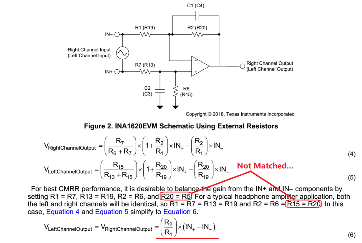

INA1620EVM: Using external resistors to set the amplifier gain in INA1620EVM User's Guide(SBOU205-March 2018)
Part Number: INA1620EVM
1. R15=R20 is Not matched...
2. If we connect the IN- to GND,and Set R1=R7=1K ohm,R2=R6=2Kohm:
when using Equation (4), ,VRightChannelOutput = (1k/(2k+1k))*(1+2k/1k) * IN+ = 1* IN+
But using Equation (6) ,VRightChannelOutput = (R2/R1) * IN+ =2 * IN+
So is there something wrong....
  • Hi Jason,
    There are two typos in the clip shown above.  First, "R5" should read "R15".
    Next, in equation 4, the first reference of R7 should be R6, so, Vrightchanneloutput = (R6/R6+R7)...  Now, when using R1=R7=1k, and R2=R6=2k, both equations will yield a gain of 2.
    Please let us know any further questions or concerns..
    Mike
