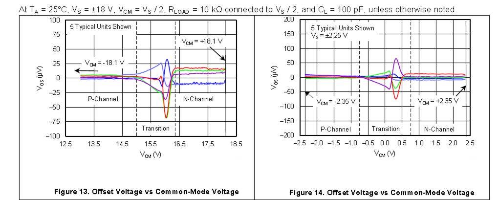

Hi team,
1. When I looked at OPA192 datasheet, I found below figures, could you please explain them for me? what is the relationship among Vs, Vcm and Vos?

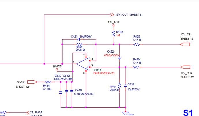

2. The customer's schematic is as below. The value of VCM is 12V and the positive power supply value is 16V. Actually the positive power supply value can change and the worst value tested is 14.1V. So do you think the customer's application has any risk? It is an urgent case.

  • Hi Sophia,
    this is very well explained in section 8.3.6 of datasheet of OPA192. I can't do it better.
    Kai
  • But the short answer is yes, as the supply dips down from nominal 16V you will get into the crossover region where you will see a varying degree of input offset shift. Some of the alternate parts might move that handover between input stages up closer to the supply. Kai, do you know in this kind of device which one might have that crossover closest to the positive supply?
  • Since in order to accomodate rail-to-rail input common-mode voltage range OPA192 topology includes two input differential pairs, this means that at certain input common-mode voltage there is a transisiton from one pair to the other. The mid-point transition between N and P channel input differential pairs in OPA192 was designed to occur at the input common-mode voltage 2.2V below positive rail; thus for Vcc=18V, this means that transition happens at Vcm=18V-2.2V=15.8V while for Vcc=2.5V the transition occurs at Vcm=2.5V-2.2V=0.3V as shown on the graphs above.
