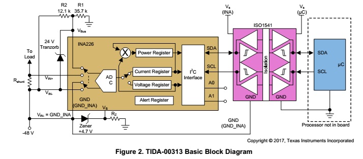

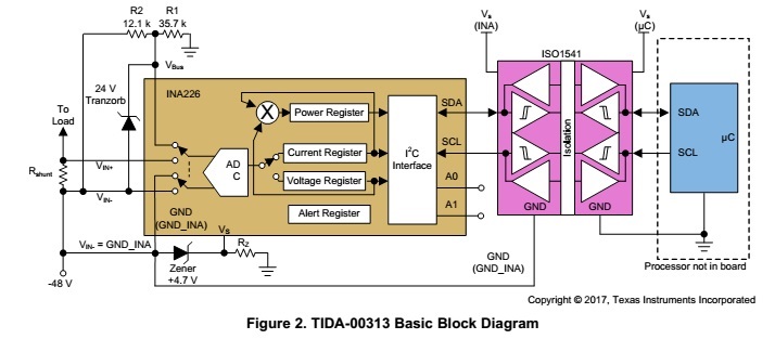

  • Hi Im using an application note as follows to read telecom -48v and current. But i am using INA233 instead of INA226.
    Following is the diagram for the same :
    Well I am able to read bus voltage at V bus with accuracy of 0.1V .However there is some linearity issue. I am applying following formula to read real world voltage .
    volts_ina = ina_data_msb;
    volts_ina <<= 8;
    volts_ina = volts_ina | ina_data_lsb;
    voltage_var = volts_ina * 0.00125;      //Vbus
    The Vbus voltage after the voltage divider resistor(R2,R1) is matching with the read result.(voltage_var).   only 0.1 V variation in it.
    But when i try to get the reading of the VIN-(GND_INA) There comes a difference of 3V in reading  on applying -59 V supply.( Applying -59 Volts gives approx 20V at the Vbus which is safe region 0 - 36 V ).
    How do i scale Vbus to read Vin-(GNd_ina).
    Is there something to do with the part number i am using.....The reference part was INA226 , i used INA233 .
    I am reading 0x88 register which reads V bus voltage which is coming fine.BUt How do i convert to real world Vin- voltage , It is not coming linear(-59.23 V  Vin- is reading as 56.122 on applying multiplication factor of 2.78625 on Vbus voltage which is 20.144V)i.e  Vbus * mult factor = Vin- as read from mcu.
  • Hi Jitender,
    The INA233 should be just as fine in your application.
    How did you obtain the scaling factor? Did you measure or simply calculate it based on nominal resistor values?. What you can do is to fit a straight line between smallest and largest Vin’s, calculate the gain, or scaling factor. This is essentially a calibration, which should provide much accurate readings.
    Regards, Guang
