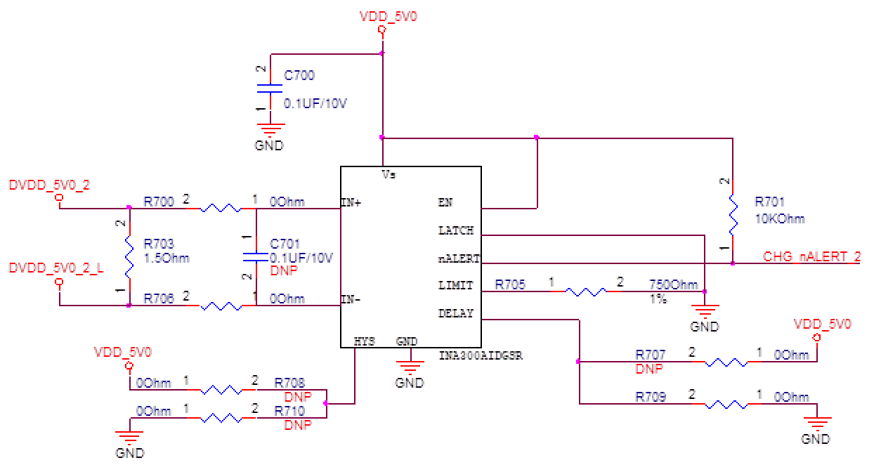

Hi Sir,
Could you help to check below SCH? Please help to provide your suggestion, if there is any concern. Thanks.
Vpwr = 5V
Itrip = 10mA
I_Max = 100mA
  • Hello Teresa,
    Functionally speaking this schematic looks good and will satisfy the listed system requirements. I will note that designer should make sure that this schematic will satisfy their error requirement. Given R705 is 1% and that ILIMIT_minimum = 19.9uA, VLIMIT_minimum could possibly become 14.775mV, which means Alert pin would trip at 14.775mV/1.5Ohm = 9.85mA. This equates to a -1.5% error in trip current.
    This is just something for customer to consider, otherwise everything looks good. Max shunt voltage is 150mV and within the input's full-scale range of 250mV. R703 will need a power rating of at least R*I^2 = 1.5*0.1^2 = 15mW.
    Delay is set for 50us and device is configured for transparent mode (LATCH = low). Hysteresis is floating so it is set to 2mV.
    Hope this helps.
    Peter

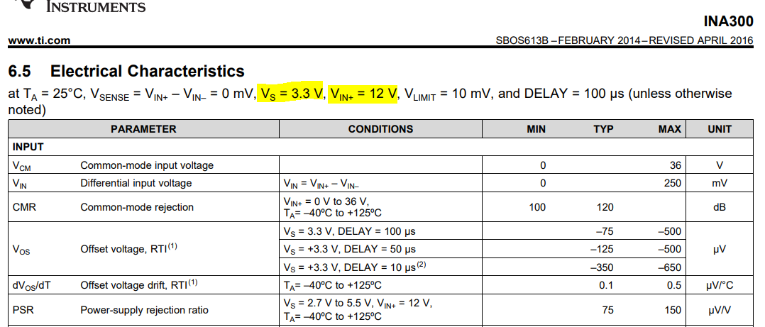

    Given 250mOhm shunt and 10mA minimum current, this yields 2.5mV Vshunt_min. With delay set to 50us, the Vos_max = 500uV. However, this Vos is when VS=3.3V and Vin+ = 12V.
    Vos_CMR_max = |12V - 5V|*10^(-100dB/20) = 70uV (over -40C to +125C)
    Vos_PSR_max = |3.3V-5V|*150uV/V = 255uV (over -40C to +125C)
    Vos_total = Vos_max + Vos_CMR_max + Vos_PSR_max = 825uV.
    Thus, once Vshunt = 2.5mV, the maximum possible error is 100*(825uV/2.5mV) = 33%. Note this error does not include the offset voltage drift as I do not know what customer's temperature range is. When using the maximum and minimum error specs, you are calculating the worst-case error.
