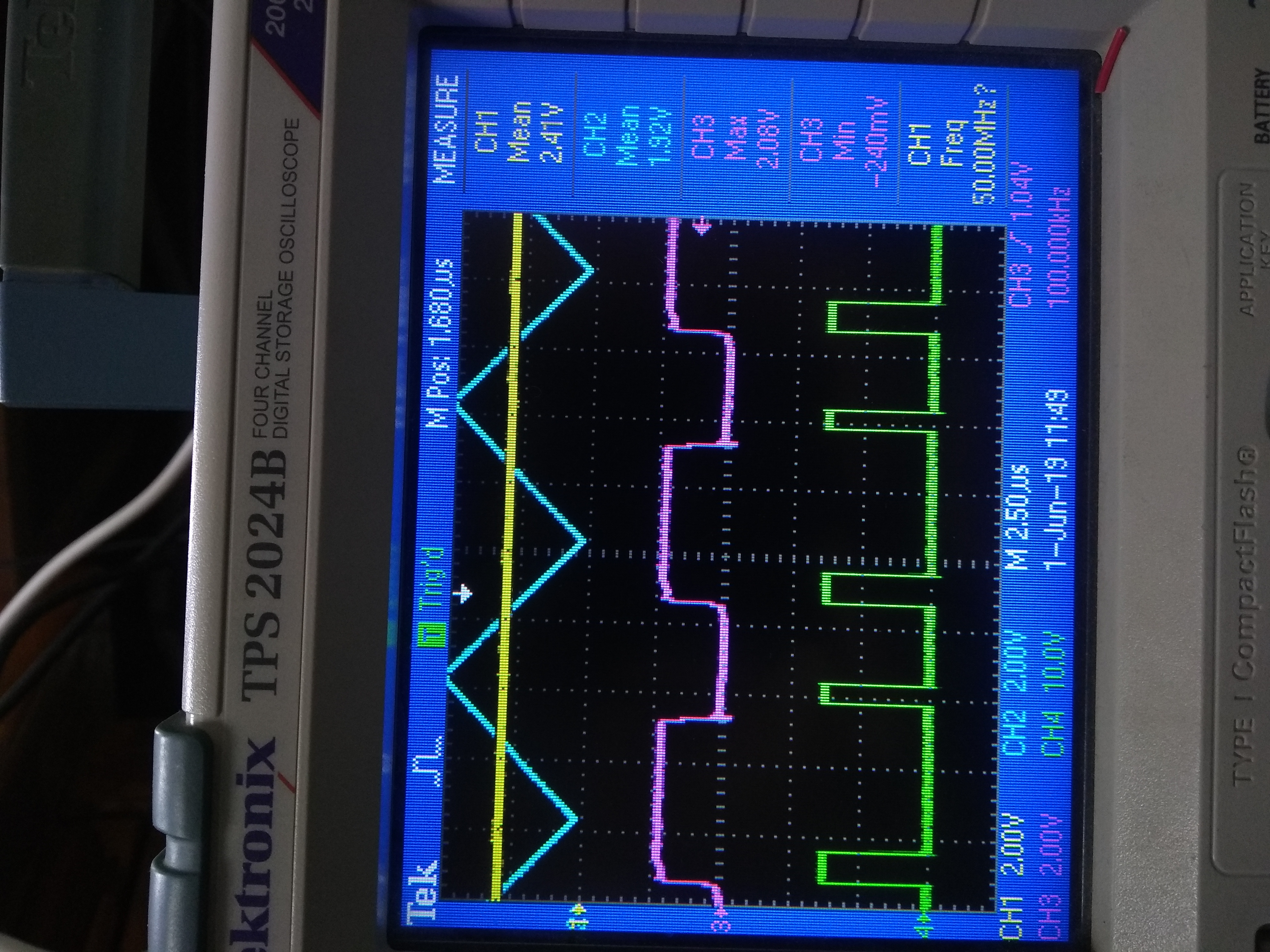

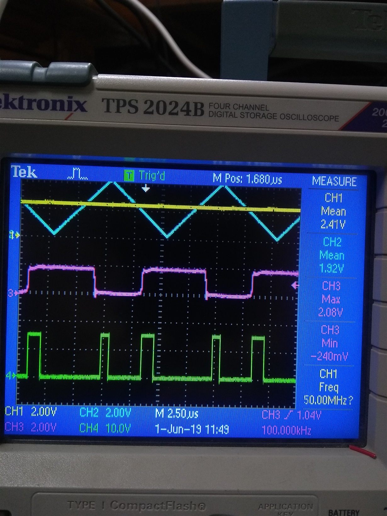

I am using OPA 552 PA as a comparator ic for generating PWM signal for gate driver FOD 3184. I connected triangular carrier signal to inverting input and DC reference signal to non inverting input. Vcc to pin 7 and ground to pin 4. but i am getting a pulse with 1.20 V offset, and when i connect this output to the input of the FOD the voltage level of output of opamp reduced. how to remove this offset.
