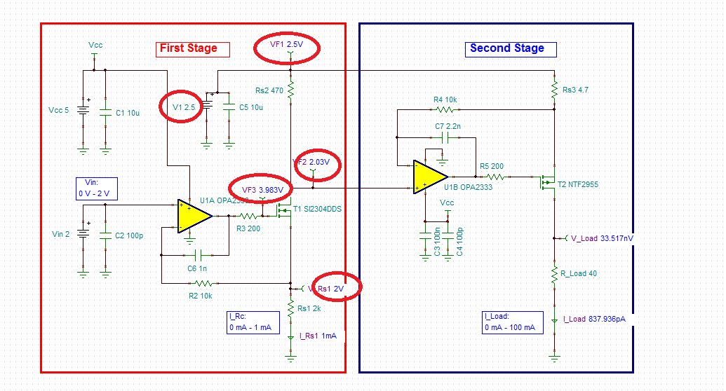

I am developing a custom laser current driver and I saw the application note TIPD102. In my application I would need to operate the laser with a max input current at 300 mA and voltage compliance of 1.5 V. Moreover I would need to set V+ = 2.048 V to match a DAC that would communicate with my PC.

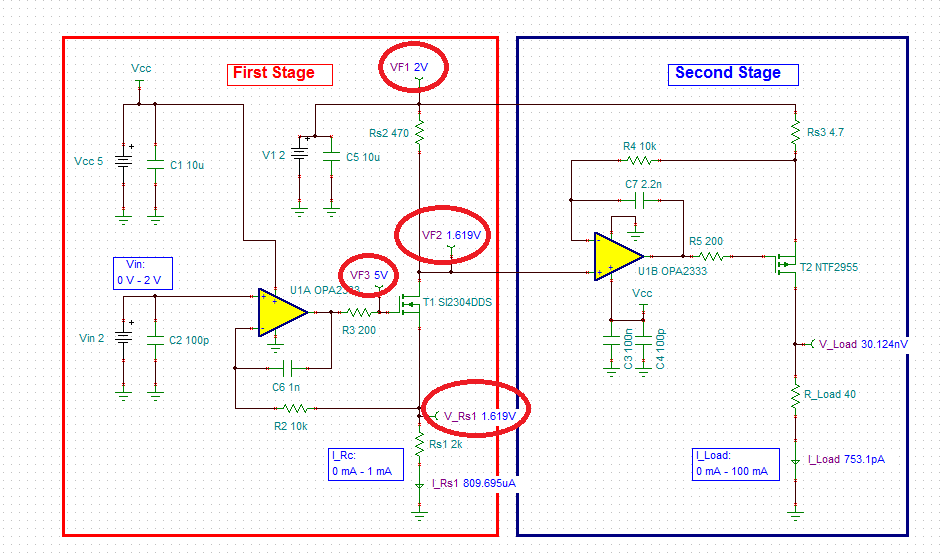

Looking at the related Tina-TI file, I tried to modify the values to match my requirements, but as soon as I reduce the value of V+ below a certain value (4.5V) the second stage of the system fails to provide voltage and therefore the I_load drops to very small values, due to the lack of voltage at the gate of the mosfet at the systems óutput. It seems to me that the issue might be related with the input of the second amplification stage, where by setting V+ to a low value, the inverting and non-inverting inputs have a values too far apart for the opa to work properly.

    I attached the file here. Ideally my schematic is exactly the same as the one found in the application note with the only difference that the voltage that supply the opamps is let at 5V and V+ can be set at a different value, in my case ideally at 2.048V.

  • The problem with your circuit is that you lowered V1 supply to 2V and you attempt to get 2V at V_Rs1 - that is NOT possible since VDS=0 and T1 MOSFET operates in a non-linear fashion (triode region).
    Thus, in order to fix the problem you have to increase V1 supply to 2.5V or lower Vin to 1.5V - see below.  Increasing V1 to 2.5V fixes the problem and I_Rs1 is at 1mA as expected - see below.
    However, T2 P-channel MOSFET model is not correct so the second stage does NOT work properly. Replacing T2 with pnp transistor fixes the problem and I_Load becomes 100mA as expected - see below.
