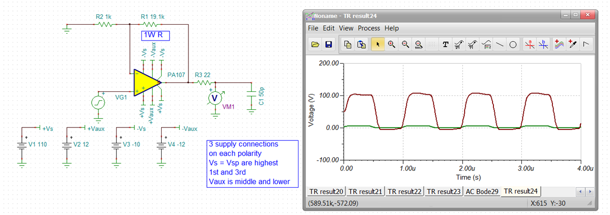

    I was already working on a different project using a device that might suit you  - you might look at the Apex PA107, I had managed to import its model into TINA (attached) but I was noticing it seemed like the slew rate was simulating much lower than the 2500V/usec specification - I used offset supplies here, which I think will be ok,but you should confirm that. The small signal gain of 20 response is 11Mhz,
    I had to slow the 0 to 5V 1MHz square wave input down to 50nsec edge, still slew limiting it looks like - in sim, that output 2000V/usec should be in spec for better shape (less overshoot)
    Here is the TINA file,
    PA107 gain of 20 100V step.TSC
  • Also, I was just kind of guessing you wanted a 0 to100V 1Mhz square wave. Whatever you actually want, keep in mind a 100V transition is going to need some slew rate - the OPA454 is extremely low on slew rate. The PA107 says it is 2500V/usec, but the model produces 1000V/usec.

    The best option for you is to find an amplifier that will do the job. The company Apex that Michael referred to specializes in these kind of amplifiers.
    A work around is just going to compound any errors, and as Michael pointed out, the slew rate of the OPA454 is insufficient for this application.
