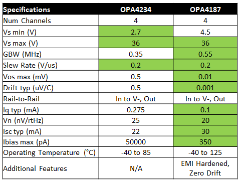

OPA4234UA/2K5 vs OPA4187IDR
If you have comparison chart of these devices in same condition, please send it to us.
Hello Kura-san,
The comparison chart will be the same. The only difference is that the OPA2234 and OPA2187 are dual-channel amplifiers, whereas the OPA4234 and OPA4187 are quad-channel amplifiers.
Hope that helps.
