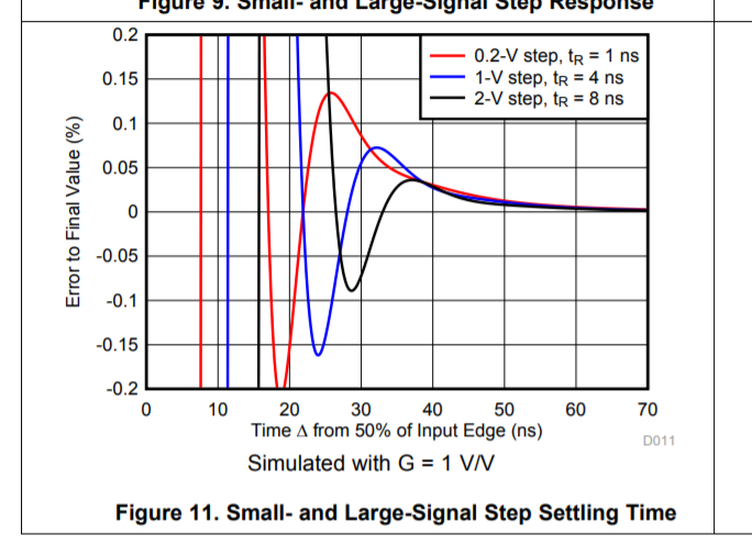

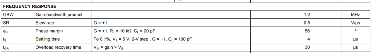

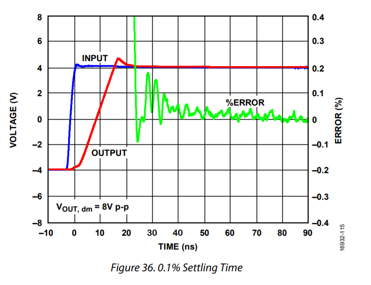

Hi, I searched about slew rate and settling time in google.
people said that if i want to measure slew rate, i should put large signal input and if i want to measure settling time, i should put small signal input.
I was confused because if i understood these factors correctly, slew rate is about slop of output voltage tracking input signal voltage and settling time is about the time needed output voltage to get to target voltage from 0.
did i understand these concepts correctly? if i did, why do we differentiate small signal and large signal when measuring these factors?
