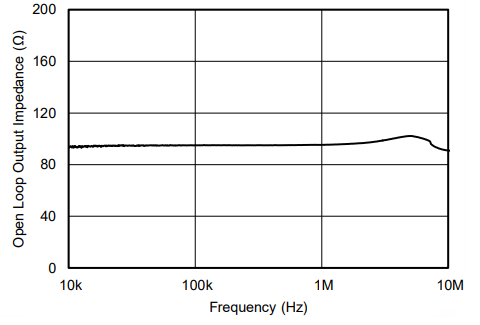

    For example, OPA1692 is a bipolar amplifier but as you can see from the datasheet the output impedance is reactive.
    OPA172 is a CMOS amplifier but the output impedance is reactive.
    TLV9062 is a CMOS amplifier but the output impedance is resistive.
