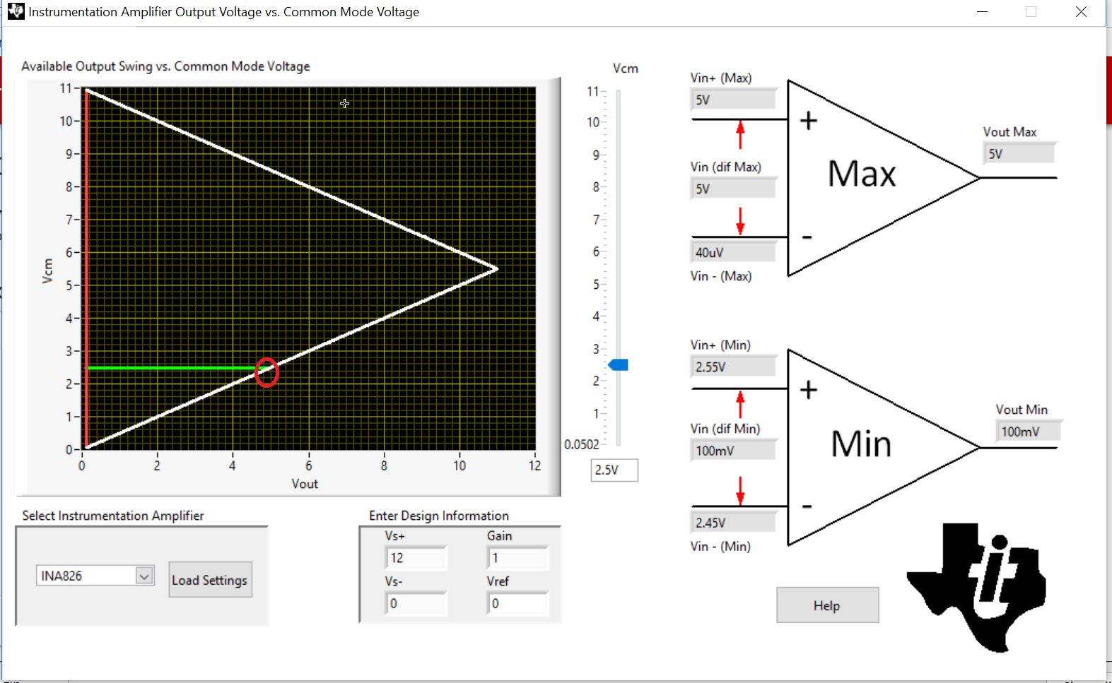

INA826: Use as a differential amplifier for 5V
Part Number: INA826
We have a design needing a differential amplifier for 5V diff in and 5V output, we chose INA826. But with "Common-Mode Input Range Calculator for Instrumentation Amplifiers", input 5V diff may make the INA826 working in margin area (Vin+ is around 5V, Vin- is around 0V, Vin diff is 5V, and then Vout is 5V). So is there any risk to use this amplifier for our purpose? Thanks.
