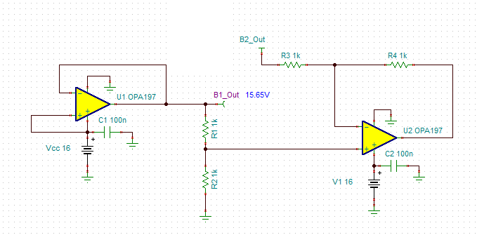

sir, I am using opa4197 as a voltage follower I am getting the same voltage from the from 7,8,14
but on 1 pin I am getting the lower voltage then applied on 3(+) pin of opa4197..
i.e 16 on the 4th pin of 4197 but getting 15.7 on 1 pin of 4197

    Can you please show an schematic to clarify the voltage supply connections, bypass capacitors and output load conditions. Please also show the voltage applied at the non-inverting input, and the voltage measured at the output of each amplifier in the schematic.   How many amplifiers show this issue?  Is the OPA4197 soldered on a PCB board?

  • I am using two opa4197 first one is unity gain voltage follower and the second one as a differential amplifier.

  • HI Saurav,
    You mention you are applying +16V on pin 4, (V+ supply), measuring 15.7V on pin 1(OUT A).
    What is the voltage on pin 3 (IN+) ?

  • BOTH PIN 3,4 IN SHORT VOLTAGE IS SAME.
  • Hi Saurav,
    The Operational amplifier's output can only swing within a few 10-100's of millivolts from the supply rails.
    The output swing of the amplifier is limited to 5 to 25mV from the rail supplies with no load (at room temperature).  The output swing range depends on the output load and temperature conditions.   In your case, since you have shorted the (V+) supply and the non-inverting input (+IN), using the amplifier in the buffer configuration, the output of the amplifier will be around 5 to 500mV below the (V+) rail supply depending on the temperature and the load condition.  In this circuit, you are placing the amplifier outside its linear range of operation since you are exceeding the output swing range of the amplifier.

  • sir that I understand that's why I chose opa4197 rail to rail opamp.
    sir, I want to make simple voltage follower and output of these follower goes to 2nd opamp which is used as a subtractor as u can see in my schematic.
    if there is any problem in my schematic please help me or suggest me sir circuit or please give me an example circuit.
    I'm trying it for a very long time but this problem occurred every time please sir give a solution.

  • Hi Saurav,
    Rail-to rail output amplifiers are only able to swing close to the supply rails. In the case of the OPA4197, the output of the amplifier can reach within 430mV of the positive supply rail when using a 2kOhm load.  In your circuit, the input impedance of the second stage amplifier is loading the output of the amplifier, and therefore the output of the buffer is only expected to reach within 430mV of the supply rail as specified on the device datasheet.
    If you need a op-amp buffer to amplify a 16-V signal, you will need to provide a supply that exceeds the input signal by some headroom.  Looking at the AOL specification of the OPA4197, a conservative approach would be to use a +16.6V supply to amplify a 16-V input signal.

    If I interpreted the post above correctly: all 4 channels of U1 (OPA4197) are setup in the buffer configuration, and all 4 channels of U2 (OPA4197) are configured in a difference amplifier configuration using 1kOhm resistors.  In this circuit, OUT1 of U1 connects to (1IN+) of U2 (also OPA4197)..  OUT1 of U1 sees a 1kOhm+1kOhm load to ground since is driving the difference amplifier on U2.
    If I understood the text on the post description above, Pin4 VCC+ of U1 and PIN3 (1IN+) are shorted together to +16V, placing 1OUT buffer on the positive rail.  In this condition, buffer1 of amplifier U1 can not swing to the positive rail since it is well outside is linear range of operation, with its input driven to the rail supply, and its output loaded with a 2kOhm load.
    Please see the customer schematic below, and TINA simulations showing the output can only swing around ~15.65V on this condition.
    The conservative approach is to design operational amplifier circuits using the AOL (open-loop gain) specification, where the output is allowed to swing 0.6V from the rail supplies when using a 2-kOhm load.
    Please use a higher voltage supply (>16.6V or so) to allow headroom for the buffer amplifier to drive the 2kOhm loaded output to 16-V and remain well in its linear range of operation.  In other words, the VCC+ supply needs to be 0.6V higher than the input signal you are required to buffer in this circuit.

    Again hardly rail to rail operation (5mV No load) is like saying " If you don't have the output connected to anything, rail to rail can be achieved." My point was as you have stated to refer to current load graphs. TI should add the word NEAR in front of the word Rail as it is no were close to Full rail to rail operation but only under no output load condition is a disingenuous datasheet description. Perhaps the industry regulation agency/s have become complacent letting marketing hype to fly under the radar!
    Note System is battery powered monitor of sorts may not be possible to raise VCC 0.6v. Perhaps changing R1/R2 (Tina) value to match load graphs Fig.15 is a better WA.
    One possible option is to increase the resistance values of the difference amplifier to 100kOhm or 1MOhm.   If the battery application is able to handle the input 1-MOhm input impedance of the difference amplifier, you may consider connecting the difference amplifier directly without a buffer stage.

    One suggestion is to eliminate the buffer stage, and configure the four channels of OPA4197 in a difference amplifier configuration using 10MOhm (or 1MOhm) resistors as shown below.
    The 4 x 4.2V battery cells produce +16.8V, and this voltage is used as a power supply for  the OPA4197.  Each cell is measured producing 4.2V at the output of each OPAx197 channel.  Please see figure and attached simulation.
