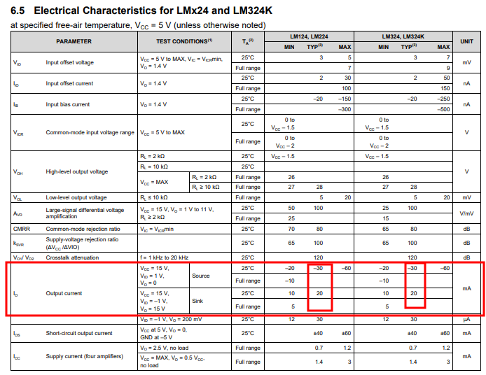

LM324: what is the Output current of LM324
Part Number: LM324
Dear TI Collegue,
 what is the output current of LM324; I check the datasheet, as below screenshot ,the typical source output current is -30mA , the typical sink output current is 20mA, i want to know ,it is the total current or every amplifier output current?
please help me check the parameter.thanks.
