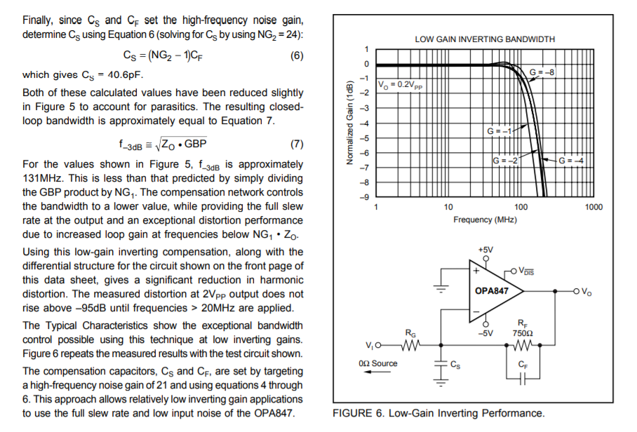

I am looking to create an amplifier that has 20 dB of gain.The amplifier is powered by a singled power supply.Can I have a schemattic diagram?
Well the data sheet shows some info, here is a basic (and there are probably at least 5more I could suggest) set up -
20dB gain (10V/V if that is what you mean) is too low for this decomp part, you would also need the twocaps shown in this section of the datasheet.
I am assuming your are AC coupled for single supply? min/max frequencies of interest?
You are being way too vague,
Your source needs to drive Rg at higher F, any limit on that or does it need to be matched
The op amp output needs to drive Rf, make sure it can
1. Moving the R's down increase loading
2. Moving the R's up increase noise and risk phase margin loss due to parasitic pole on V-
The OPA847 requires a minimum gain of 12 V/V to be stable. Are you able to use a higher gain for your circuit?
