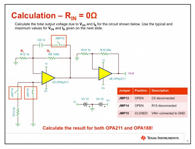

I am writing to enquire about one problem I met on '2.2 TI Precision Labs - Op Amps: Vos and Ib - Lab'.
the screenshot below shows the schematic.

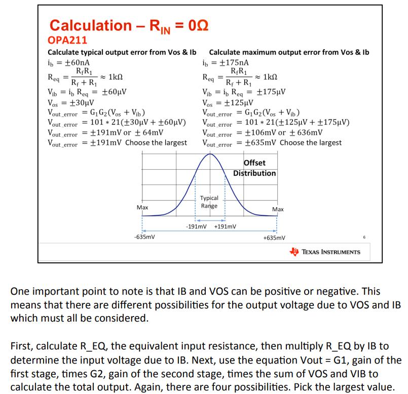

And at 03:06, it shows a Req calculation in pic below:
I am confused by why 'Req = Rf R1 /(Rf + R1).'
can anyone please help on this?
thanks,
Jim
  • Hey Jim,
    That looks like an error to me. If the V+ node is grounded, the output error due to inverting Ib is -Ib*Rf ( often Ib is unipolar. The OPA211 spec table looks be in error also shows a +/-200nA whereas the schematic shows an NPN differential input - unless there is bias current cancellation not being shown, the input bias current is unipolar into the device - that give an output error showing a positive shift (From Vos*noise gain error)  in the Vo as +Ib*Rf. The Rf||Rg calculation in the video is heading towards a bias current cancellation where you make the DC source R on the V+ input equal to that. That will then reduce the DC output error due to input bias currents of that first stage to +/-Ios*Rf where Ios is almost always bipolar mismatch currents.

  • Hello Jim,
    "I am confused by why 'Req = Rf R1 /(Rf + R1)."
    The OPA211, or any Op amp in this circuit configuration has its inverting input the summing node connected to one node of the R1 input resistor and one node of the the RF feedback resistor. The other end of R1 connects to ground (~zero impedance) and the other end of RF connects to the Op amp output - a very low impedance also. So as far as the impedance that the inverting input sees it is R1 || RF, or Req = (RF R1) / (RF + R1).
    The OPA211 inverting input bias current is provided by these two resistors as the sum of the current through them. How much R1 and RF each provides towards the necessary input bias current is a function of the voltage offset of the Op amp, the circuit's closed-loop noise gain, and the sign of the output referred voltage offset.
    Regards, Thomas

  • Huh?? I have never seen that before - if you sum output DC errors through superposition, the inverting bias current (since V- is at zero volts) goes only through the Rf resistor as a gain element to the output. You could perhaps model it as a voltage on the inverting node that is Ib *(Rf||R1) that then has a voltage gain to the output of (Rf+R1)/R1 that, if you multiply that out, gets you back to a gain of Rf - or you could just use Rf as the gain.
  • But really, if you are doing superposition and the V+ input is grounded with no Vos error, the inverting node is also at ground - the approach shown in the video will not show up in sim
  • That is correct. OPA211 does have the input bias cancellation circuitry (as indicated in the datasheet by +/- sign in front of IB) and for that reason you may NOT attempt to cancel IB related error by adding a parallel combination of R1||Rf in series with the non-inverting input. Doing so, may instead double the error in case +IB and –IB currents happen to flow in the opposite direction).
    If you assume the inherent Vos=0, the IB generated input voltage error is Vin_error [IB] = IB*(Rf||Rin) = IB*R1*Rf/(R1+Rf) but after referencing it to the output, Vout_error [IB] = Vin_error*Gain = -[IB*R1*Rf/(R1+Rf)]*[(R1+Rf)/R1] and therefore, Vout_error [IB] = -IB*Rf, as expected.

    My calculations:
    ib_U5, bias current of the first OPA211 (U5 in the schematic below).
    ib_U6, bias current of the first OPA211 (U6 in the schematic below).
    Vout_error_ib = ib_U5 x Req x G1 x G2 + ib_U6 x Req2 x G2 = ib_U5 x Rf R1/(Rf +R1) x (R1+Rf)/R1 x G2 + ib_U6 x Req2 x G2
     =  ib_U5 x Rf x (R10+R14)/R14 + ib_U6 x R10*R14/(R10+R14) x (R10+R14)/R14
    =  ib_U5 x Rf x G2 + ib_U6 x R10
    It seems that the lecturer has omitted 'ib_U6 x R10', error brought by the bias current of the second OPA211.
    Can you please correct me if I was wrong?
    Jim.
  • Hi Marek,
    Thanks for your reply.
    I think that Vout_error [IB] = -IB*Rf is the error to the output of the first stage opa211.
    I am confused by how the lecturer calculated that total IB error.
    To get the total IB error to the final output (error output of the second opa211), i think
    Vout_error [IB] _ total =  -IB_U5 * Rf  *G2 + IB_U6 *R10

  • Yes Jim, the precision labs is confusing, the new model shows this if I just run a DC simulation.
    So the model has 30.56uV input offset, that gets to the output times 2 or about 61uV - taking that from the output 411uV leaves 350uV to explain. That is 350uV/10k = 35nA going into the V-node. both of these make sense relative to the typical data sheet numbers. The bias current does not move the V- node. If we thought that it did, that 35nA times 5k would be a -175uV on the V- nodes and we do not see that since the loop holds the V-node at ground + Vos.
  • Jim,
    Yes, that's correct: Vout_error [IB] = -IB*Rf is the IB related error at the output of the first stage.  Even though, as you correctly pointed out, the total IB related error at the output of second stage is: Vout_error [IB] _ total =  -IB_U5 * Rf  *G2 +/- IB_U6 *R10, the second term (IB_U6*R10) contribution is 101 times smaller than the error of the first stage (it's NOT gained up by 101) and for that reason it has been neglected in TI Precision Lab lecture.

  • Hi Jim,
    Regarding your question, "It seems that the lecturer has omitted 'ib_U6 x R10', error brought by the bias current of the second OPA211.
    Can you please correct me if I was wrong?"
    You are not wrong, the Vosi and Ib contributions to offset contributed by the OPA211 second stage were not included in the analysis. I believe that was done for simplicity's sake when this subject is being explained.
    The noise gain of the U5 stage is -100 V/V and the noise gain of the second stage is -21 V/V, for an overall gain of 2100 V/V. The Vosi and Ib offset-related factors of the first stage are amplified by that amount. Where as the Vosi and Ib offset-related factors of the second stage are amplified by -21 V/V. Therefore, the offset errors contributed by the first stage far overshadow those contributed by the second stage. Most of the error voltage seen at the output (Vout) will be due to the contributions of the first stage.
    Regards, Thomas
    Precision Amplifiers Applications Engineering
  • Tom, I already addressed this question before:
  • Hi Marek,
    Thanks for that reply. Now it makes sense.
    Jim.
