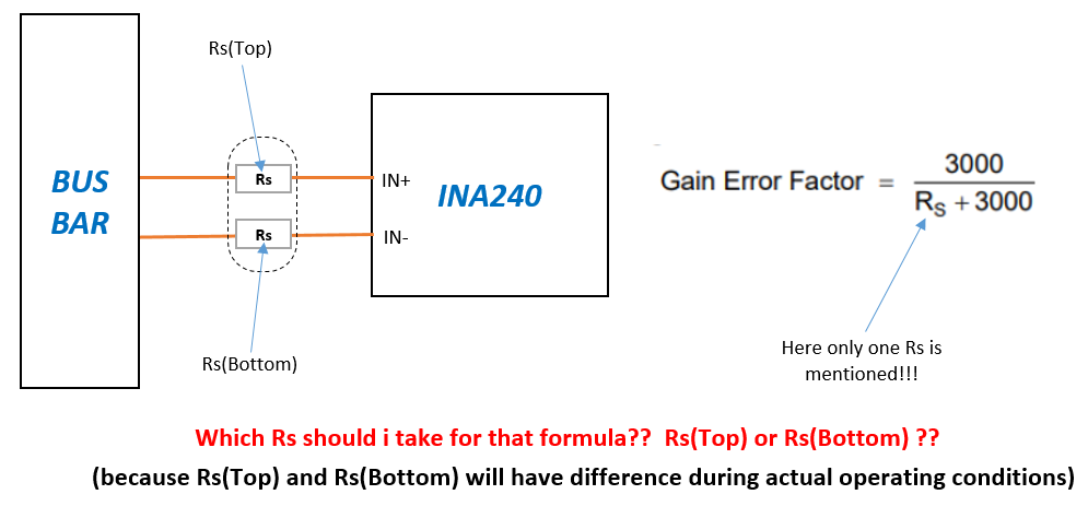

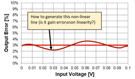

Hi Team, Please let us know which parameter will be affected by non-linearity error. (for example: Current sense input, Gain,input offset voltage or reference input voltage). Suggest a formula to calculate output voltage by considering errors seperately (Instead of sum of squares method).
