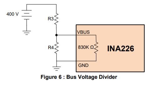

  • Hi Guang,
    Thank you for your reply.
    >Fortunately for Vbus pin, ratio matters and absolute value doesn’t at all, because Vbus is measured based on a ratio.
    ⇒Does it mean following circuit of TIDU849 ?
       I think that if R4 is mush smaller than 830kΩ, the variation of 830kΩ is not large affect, right?
       http://www.ti.com/lit/ug/tidu849/tidu849.pdf
    In my case, Vbus pin is connected between external 15kΩ(high accuracy) and internal 830k. These 15kΩ and 830kΩ are connected in series.
    Then ADC of INA230 shows approximately  3.25V, so I measure the ratio of series resistance that internal register is 890kΩ.
    The variation of  internal 830kΩ causes accuracy error in my system.
    So I will calibrate it through software.
    ttd
    You’re exactly right – if R4 is made much smaller than 830K, then the error effect of the Vbus pin input resistance is negligible in Figure 6.
    If you only have a 15K in series with Vbus pin, it will form a voltage divider with 830K. The effect is that measured bus voltage is a portion of what it actually is. You can certainly calibrate the measurement. Is there any reason in keeping the 15K? Why not just short it out.
    Regards, Guang
