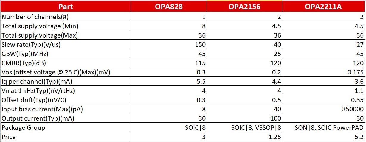

Does the OPA828 have the dual channel package?
thanks
Hi Alex,
Thank you reaching out. Unfortunately, we do not have a dual version for the OPA828 at this time. The closest thing we have to OPA828 in a dual version is the OPA2156 and OPA2211A. Depending on your design requirements, one of these parts may fit your needs.
Please see the below comparison table below:
I hope this answers your question.
