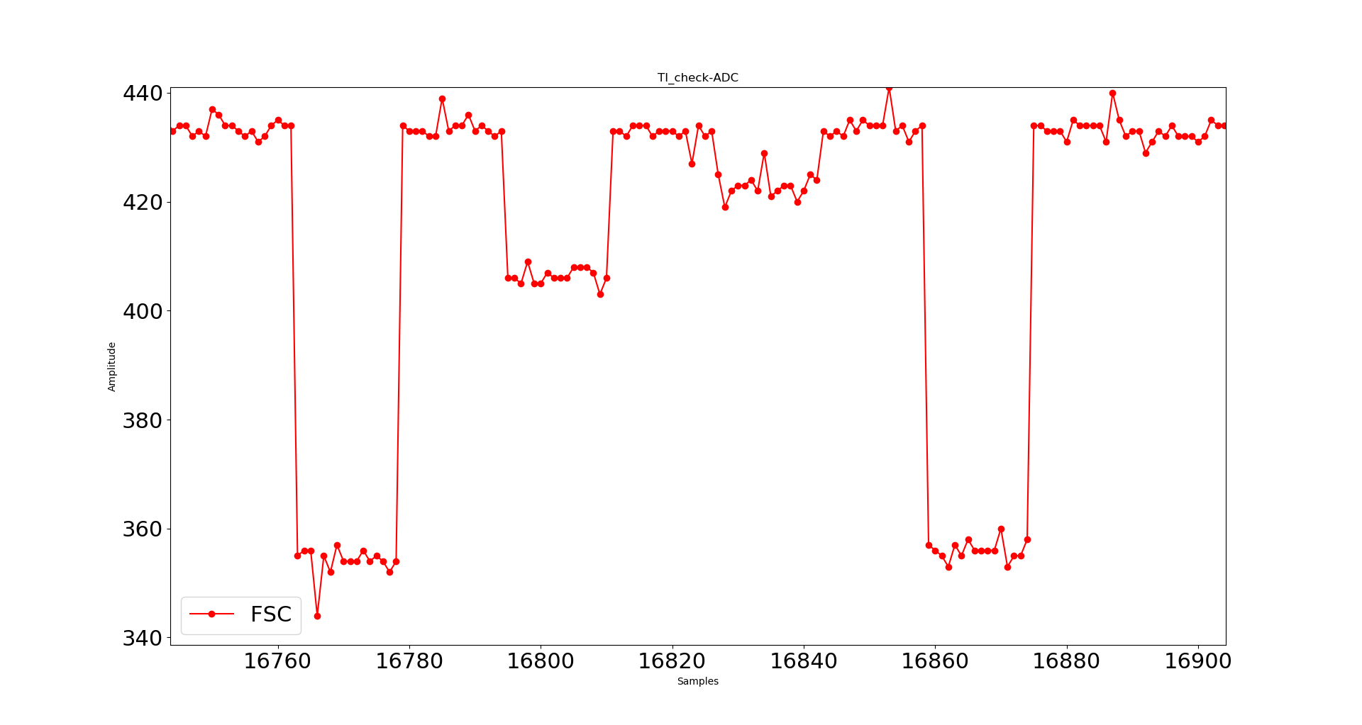

Hey, everyone!
I am using TI Hercules RM57Lx LaunchPad to signals from a photodiode. The photodiode gives a negative voltage, so, I am using TL072 IC for getting an amplified inverted signal. I connect to output from the TL072 IC to AD0 ( which is the input for ADC) on the RM57Lx microcontroller board.
When the data is collected and plotted, it is seen that they are not really continuous but in groups of 16 points. I am also attaching a cropped image of the plot for reference.
Please, tell me what is the issue and how to resolve that.
Thanks and regards,
Apurv

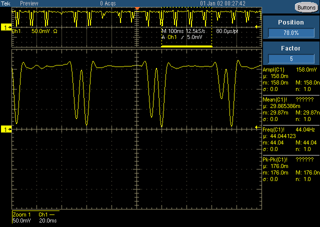

  • Hi Apurv,
    What is the input to TL072A? Can you also provide a waveform of the output before going to the ADC?
    Bala Ravi
  • Hi, Bala!
    The input to TL072A is from the photodiode, would be around 15mV.
    Below is the waveform of the output before it goes to the ADC:
    Thank you.
    Apurv

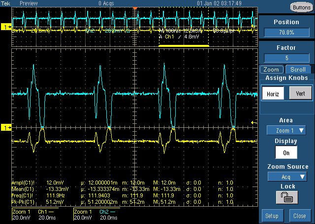

  • Hi Apurv,
    Can you please share your schematic? I would like to look at your inverting-amplifier circuit. Also can you please provide the output of photodiode and output of TL072A in the same screenshot?
    Bala Ravi
  • Hey, I do not have a drawn schematic but the following is the screenshot that you asked for.
    The blue one is the output from TL072 and the yellow one is from the photodiode.
    I think the inverting circuit is working fine. I have kept a gain of 2.5.
    But, still, the ADC output from RM57Lx is not accurate. The ADC output is below (not exactly corresponding to the above figure as taken at different times):
    Why are the points grouped in 16 points?
    Thank you for your time.
    Apurv
