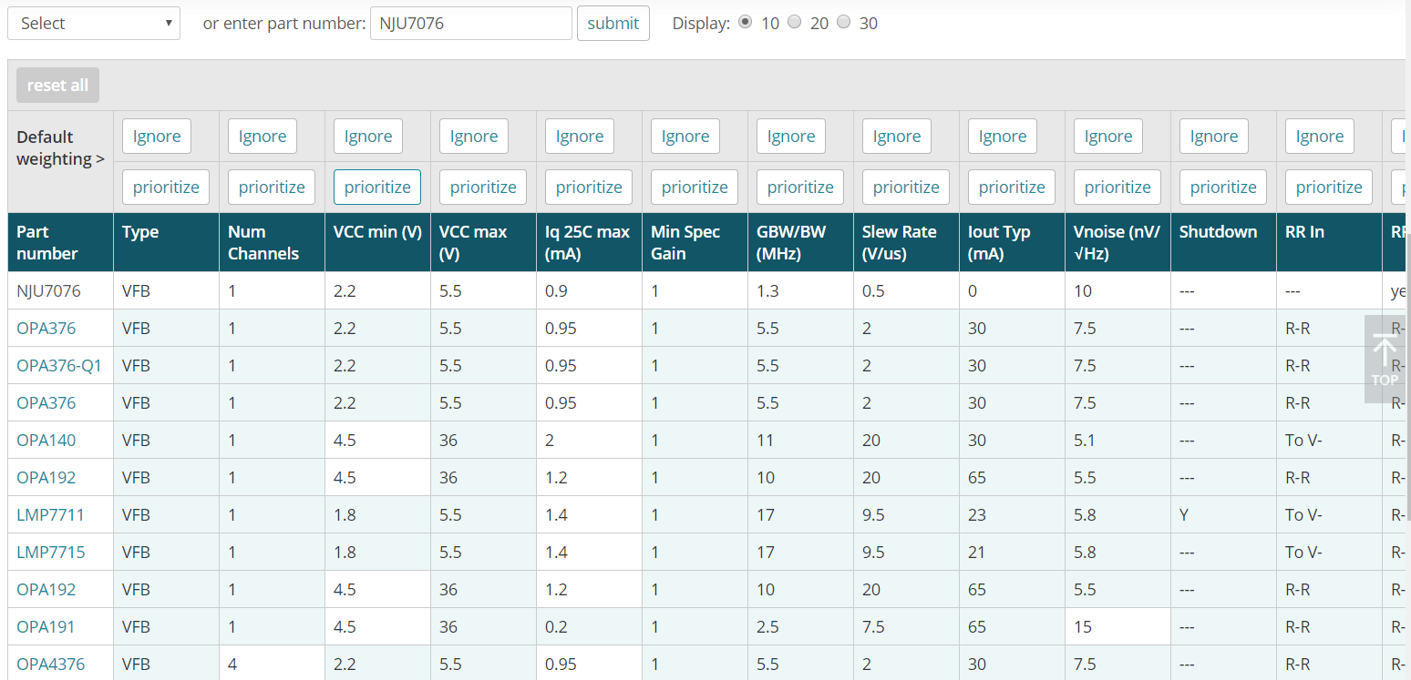

  • Well the parametric cross reference suggests the OPA376 family, there are likely slower parts in the TLV line that would work but I can't get those to show up here. I was trying to limit to 5.5V max Vcc, but could not in this tool - I seems to always deliver kind of much higher supply range options which probably not too interesting for a 5V CMOS crosses.

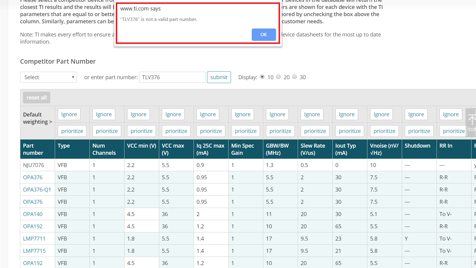

  • Yea, that sort of spec downgrade version, the TLV376 would be better, I did put that in the cross reference tool and the reason it was not showing up is it has not been loaded in apparently - I suspect this tool is not being updated anymore, I wonder what the new BOM cross tool would return for this?

    Hi Michael,
    I'm not able to find the TLV376 using the tool either...strange.  I'll dig into it internally and find out what's going on.

    Michael,
    Looks like this part was missed when transferring information to the backend for the tool.  I've been told this will be corrected.
    There's also a new tool available for comparing TI parts with competitor parts called the BOM Cross Tool.  You may try this instead, although it's rather new and still being improved.

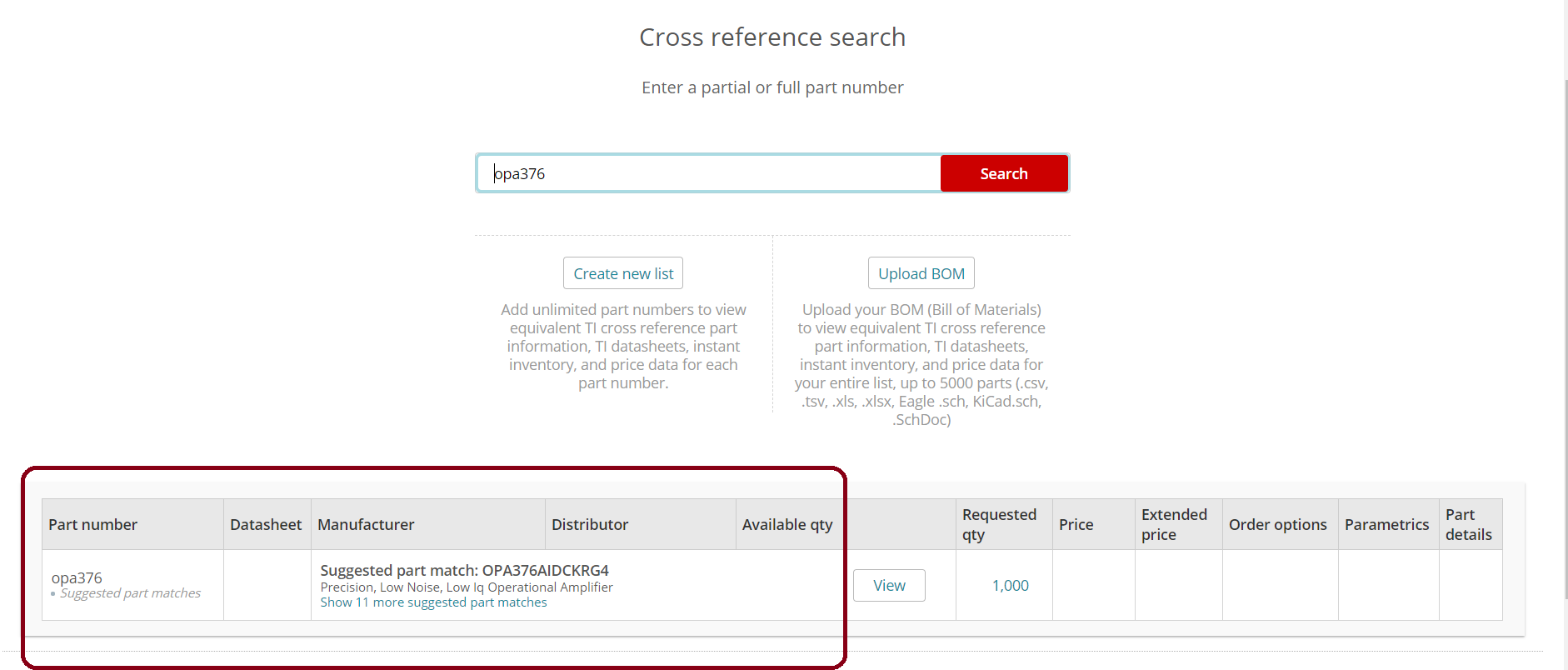

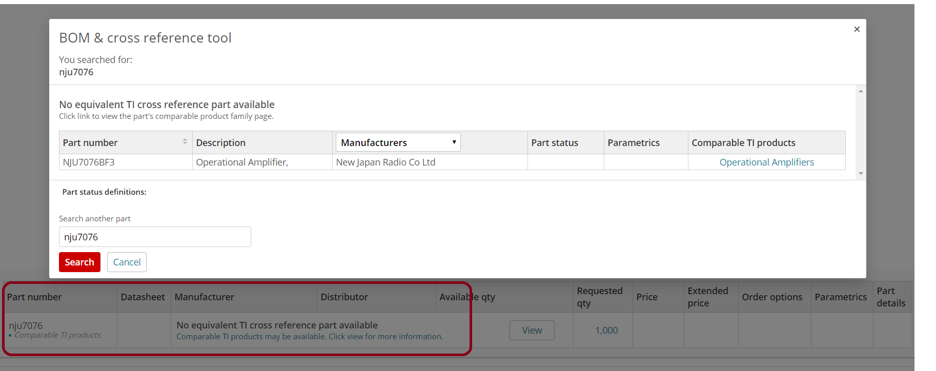

  • Not ready for prime time is more like it - if I put the NJR part in, nothing comes back -
    If I put the OPA376 in, it only shows me the OPA376, the older tool was handy to find close TI parts as well,
    I think that BOM tool is using a purchased 3rd party database. The older TI tool was a very carefully built, internally consistent, parametric database. Having done more than 150 datasheets, and analyzed 1000' more, there is plenty of latitude for some numbers - for instance, what is output current - often, the biggest number the marketer thinks he can get away with - that sort of GIGO operation is feeding into the BOM tool I suspect.

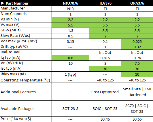

    0 Former Member in reply to Sean Liao (Yu-Sheng)
    Hello Sean,
    Please see the image below.
    Daniel
  • Hi Daniel,
    Is OPA376 and TLV376 same die and p-p?
    What is the difference between them to cause the different price. thanks!
  • Former Member
    Hi Sean,
    The primary difference between the parts is that the OPA device is tested more extensively so the customer will get a better performance guarantee as listed in the datasheet.
    The two parts are P2P.  As for what is going on inside the parts, we prefer not to go into those details.  I hope you will understand.
