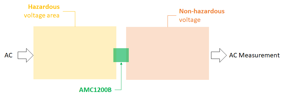

A system is using the AMC1200B to measure the AC voltage between the primary and secondary of a SMPS.
In order to complies with  IEC 62368-1 safety standard, the certification laboratory is requesting IEC60747-5-5 certification.
Please, may I know is this certification is available for the P/N AMC1200BDWVR?

  • Hi Lao,
    This certification appears to apply to opto/photocoupler devices which does not apply to the AMC1200. The AMC1200 uses a capacitive isolation barrier.
    The certifications that you pointed to are the only certifications that we have for this device.

    As you mentioned and confirmed, I shared same info  that standards doesn’t apply to digital isolators. In this case, the laboratory still request certification for optocouplers.
    Please, may you let me know if this part is used in this kind of applications, involving the primary and secondary in a SMPS.
    Thanks again
  • Hi Lao,
    Yes, this device is used in applications that require isolation - however optocouplers/photodiodes are not used. This device uses capacitors to transfer digital data across the barrier.

  • Hi Lao Hu,
    Here is a paper that describes some of the differences between optical and digital isolation devices.  I don't know of any specific requirement to use optical isolation devices in equipment that is subject to IEC 62368-1 testing.  As Alex mentioned, our AMC1200 is certified to the digital coupler standards and to the best of my knowledge should meet IEC 62368-1 requirements.

  • Hi Lao Hu,
    I believe you are right, the equipment standards should only be looking for isolation voltage levels, minimum spacings (creepage/clearance), etc.  As I said before, I'm not aware of any that specifically say you must adhere to a particular component standard.  Sure - if you are using an OPTO, that component would ideally adhere to the IEC 60747-5-5.  If you like, I can send you a note offline and perhaps we can discuss the mater with your test house.
