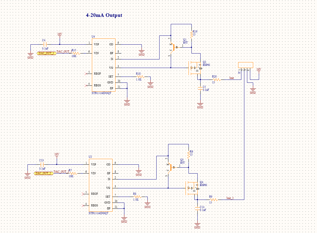

When i powered up my device the output is correct but after powered up the device mosfet start heating and continuously increases.
Attached schematic of the design,
MOSFET Used - BSP170
BJT Used - 863-SMMBT2907ALT3G

  • DACOUT Voltage in range of 0.1 to 3 Volts and load resistor is 15 Ohm, but yes regulator voltage pin is not in used and open .

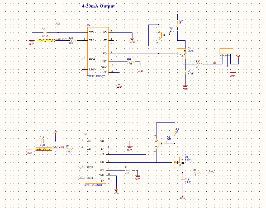

  • Yes sir both Q2 and Q4 exhibiting the heating issue.
    BJT Q1 and Q3 - 863-SMMBT2907ALT3G
    Attached Gerber file and schematic

  • Hi Dheeraj,
    From the schematic perspective, the recommendations are as follows:
    - If the voltage regulator is not used, please short the XTR111 U4 and U2, REG_F and REF_S, and connect to a 470nF bypass capacitor to GND.   This will avoid potential issues with the internal regulator amplifier being open loop/unstable.
    - It is recommended to add protection circuitry such as transient voltage suppressor (TVS) diodes at the drain of Q4/Q2 (IOUT external connection).  For an example, please refer to the XTR111 Evaluation Module User's Guide.
