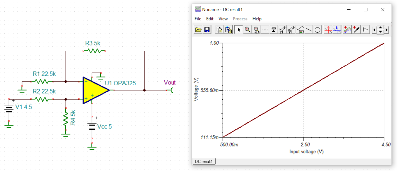

  • Hi Bhautik,
    A simple solution to this would be to use a precision amplifier (like the OPA325) and configure it as a difference amplifier with an attenuating gain of 0.222V/V.
    • When Vin is 0.5V, Vout is 0.1mV.
    • When Vin is 4.5V, Vout is 1V.
    Is this acceptable? I have attached my TINA Spice file below and a simulation image.
    1261.OPA325 - diff amp.TSC
    -Tamara
  • Hello Tamara,
                It seems that when Vin is 0.5v,Vout is 0.1v instead of 0.1mv which you stated. And Vout = 100mv is not acceptable when Vin = 0.5v.
               Could you please check it and confirm that it is 0.1v or 0.1mv when Vin = 0.5. ?

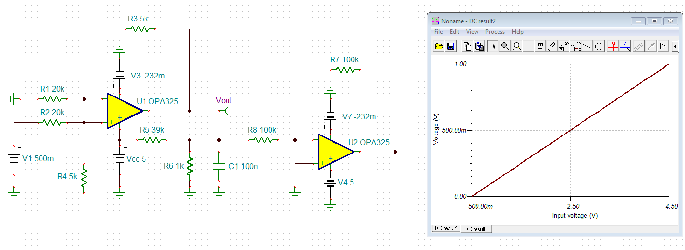

  • Hi Bauthik,
    you could add the low-noise negative bias generator LM7705 to provide an auxiliary voltage of -0.232V. This would allow the OPAmp to fully go down to 0V at the output. So, you could modify Tamara's circuit in such a way:
    Here, the 5V supply is used to generate another auxiliary voltage of -0.125V, needed to carry out the substraction. This can be done, if your 5V supply voltage is sufficiently precise and stable. (Strictly speaking R6 should be 1.01k and not 1k). But, of course, you can use any other precise voltage you already have in your circuit. The LM7705, on the other hand, should not be used as a reference voltage source, because it might not be precise enough. But there's nothing better than the LM7705 to generate this negative auxiliary voltage to power the OPAmp.
    Instead of two OPA325 you can use one OPA2325, or course.
    You can add a small ceramic cap of some dozens of pF in parallel to R3 and R7 each. This will improve the stability of the circuit by adding some phase margin at high frequencies. Provide proper power supply decoupling as well. And if you want to connect a load with a nonvanishing capacitance to the output, mount an "isolation" resistor of 47...100R directly at the output.
    Kai
