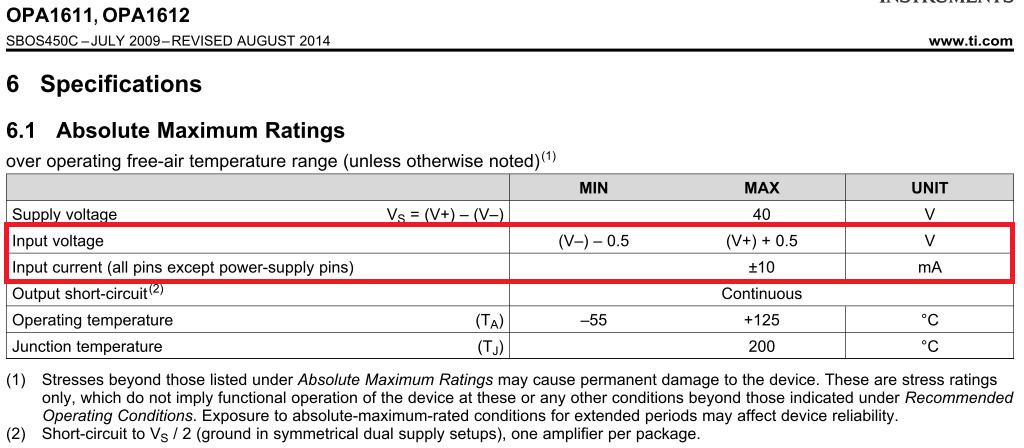

Could you please tell me whether the input terminals of LM6172 are protected from excessive differential voltage with back-to-back diodes like as the input protection circuitry on OPA1611 ?
