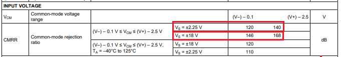

    1) Fig. 14 states CMRR and PSRR in the ~140 dB ballpark. Yet Figs. 15&16 and several passages in the text mention much higher values. So what is correct?
    Note these are "Typical Characteristics" curves. Figure 14 is CMRR and PSRR vs Frequency are ac tests, while Figure 15 and 16 are CMRR and PSRR vs temperature which are dc tests. These measurements were made on different platforms and the resolution is different for the two of them. Resolving the difference between 160 db (10 nV/V) and 140 dB (100 nV/V) is in the realm of the limits of practical measurement capability.
    Also, CMRR is a function of supply voltage-see below:
    It is best to use the CMRR and PSRR information provided in the OPA2189 Electrical Characteristics table. The performances listed in that table are what TI assures.
